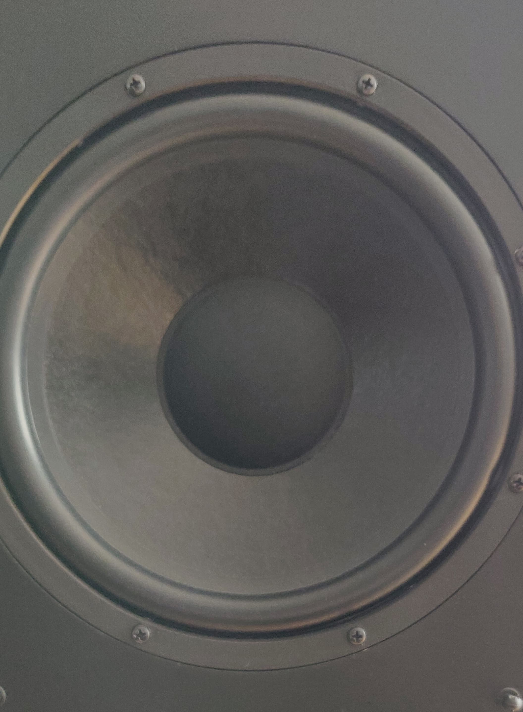

Hi all, just wondering what your opinions would be on rotating a woofer to re center it. I'm using some 20 year old PSB stratus goldi and have noticed what appears to be some woofer sag, I can't say there is any distortion in the sound but was wondering if I should rotate the drivers to prolong their life?

Has anybody ever rotated a woofer? I never have and am unsure if I should attempt it? I have never opened up any speakers and wondering if I loosen the screws should I use some locktight when re screwing them? Any opinions would be helpful. Thanks

As long as the voice coil/former is still in alignment, that isn't a big deal. Do you ever hear distorted sound or buzzing or other odd noises from the woofer?
Hi all, just wondering what your opinions would be on rotating a woofer to re center it. I'm using some 20 year old PSB stratus goldi and have noticed what appears to be some woofer sag, I can't say there is any distortion in the sound but was wondering if I should rotate the drivers to prolong their life?View attachment 45390
By the look of that speaker, I would rotate it through 180 degrees. If it does get to the point of gap rub, it will be too late. It should be simple to do the job. I would not use Locktite. As long as you do not overtighten the screws, I doubt you will have a problem. If you do there is always the reliable carpenters glue and toothpick technique.
Have not heard any distortion from them, I just want to make sure they stay in tip top shape.
Ok thanks for the advice, I'll give it a shot on the weekend.

ya i took the screws out but was unable to lift the woofer out of its recess in the box, so i just put the screws back in....i guess it will just have to stay this way.
Can't lift the woofer? You should lift some weights :p
Sometimes tilting the box forward a bit can help remove the driver (be sure to catch it, tho). Sometimes whatever was used as a gasket between driver and box can be pretty sticky, too.....
A bicycle tire lever is the best implement to easy it out. If you are careful you can use the flat blade of a screwdriver. You always have to lever a driver out gently.
ahhh that makes sense, it felt pretty firmly in there. ill give it another shot then.

Figured out that the space between the woofer and box is normal and just a slightly miss aligned woofer, so all is good. Although it did have a crack on the rubber surround, so i decided to replace it. PSB was able to ship me two replacements, wasn't cheap but whatever sounds like knew and I have peace of mind.
