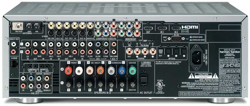

This is just an assumption on my part so please read your user manual as I always run a Denon/Marantz setup with external power amps for my LRC. But it’s very possible that if the impedance seen by the AVR is too low it will go into a protection mode and shut down before any significant and permanent damage can occur. I could very well be wrong however. Does your Harmon have preouts? You could pick up a cheap 4ohm power amp if needed.
Trebdp83
The Daytons are not exactly efficient but the receiver has pre outs. I run two pair of the MK442Ts and an MK442 center channel and things can get warm after hours of spirited listening.
scoodilywoo
Yeah it has preouts, and I do have stereo 4ohm amp's. So your saying use the pre amp's to the external amp that has 4 ohm loads, and run it that way? I have no idea why I didnt think of that lol.... Thank's for pointing that out to me :) Would i be able to still use the menu from the receiver to setup the distance of the speaker's etc?
W
warnerwh
Yes you will still be able to use the menu from the receiver.

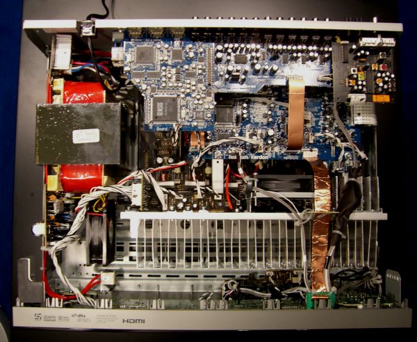

The AVR247 will drive 4 Ohm loudspeakers just fine, but to comment further U need to confirm a few points:
1. Does the 247 have the 4-5" free-air clearance for the L/R sides and top cover?
2. What is the average volume level?
3. Size of listening room
4. Type of source material, compressed or uncompressed?
5. Are U using it in 5.1 or 7.1 mode, if 7.1 power supply demands will be higher
Since we were the lead design engineer for the 247 we do know little about it.. :oops: Note that the 247 will run hot @ idle and low output, as it biased high to minimize x-over distortion. The 247 amplifier section was designed by R.Miller of HK New York, who designed some of the highly rated HK Citation amplifiers and does handle 4 Ohm loads just fine within reason.. ;) The 247 does have built-in fans if the internal temperature climbs too high.. Note that the mentioned Dayton MK442T loudspeakers besides being 4 Ohm, have a low sensitivity spec of 87dB so they do require significant current to drive to higher SPL levels. The 247 was an entry-level AVR and now is 15 years old so it is dated but in its day was 1 of the top selling AVRs world-wide...
Just my $0.02... ;)
