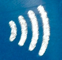

My card has a chip... also a little icon w/ 4 ")" shapes each a little bigger than the last... kinda like an icon of sound waves coming out of a speaker. Does that mean it has RFID?
Not sure, can you post photo? (edit out private info of course)
Also did the bank advertize you could pay with it just with tapping the terminal?

This is the symbol...
Not sure how it was advertised to us. My wife handles all that, and she's the one that decided we needed protective sleeves. I'll ask her.
It looks like your card does have RFID - Probably good idea to keep in rfid protective sleeve...
