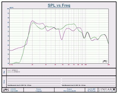

Here is a comparison Gene did of dual 8" sealed subs (green) vs one ported 12" sub (red):
Note that the single 12" did provide a higher max SPL level (which this graph would not reflect).
Also, understand that the large deviations from a flat curve are due to room effects and this demonstrates mainly how two subs smooth out the in room response!
