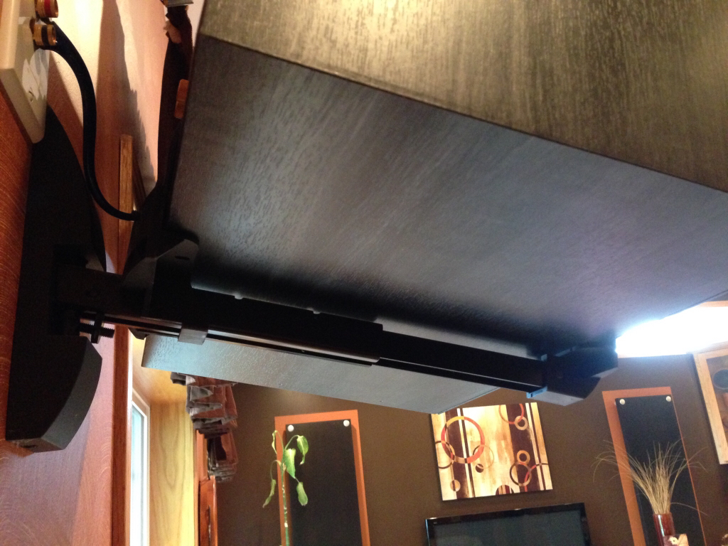

To many people to quote lol. It was a Magnolia associate and I guess I did a poor job at describing my current setup. I have uploaded a photo to show but let me explain.
We just moved into a new house and I have a surround system I pieced together from old speakers and bought an amp and a sub to replace the old amp/sub combo that came with the speakers.
When I went to set everything up and install my surround speakers I ran into a problem with wires running across the floor. So I went to Best Buy and talked to the Magnolia guy and showed him the picture I have uploaded. Let me correct my earlier statement, he recommended my surround and rear speakers being in the ceiling and replacing my front and center speakers later with floor standing and a better center speaker. He gave me a couple options, speakercraft aim7 series and Niles cm7bg. I would continue to use my current front speakers and center speaker until I could afford the next upgrade.
Hope this helps and let me know what you guys think.
Thanks!
P.S. I'm on my phone and the picture won't upload, too large. I will post once I get on my laptop.

Interesting deal. From the picture, I might be inclined to rotate the system 90deg to one of the end walls. If you do go in wall, those angled sides might give a better angle to the LP. Also, the angled wall above the mains might add some funny reflections.(maybe). What are your mains and center, and budget? Fwiw, you can get in walls from jbl, kef, Martin Logan etc too. This makes it easier to timbre match. While it's not critical to match, it does yield benefits as mentioned, and my recommendation is that IF you can, you should. I like to go to BB and mess with their heads. Lol
Most of us aren't fans of in wall speakers but, sometimes that's just what works. As far as hiding wires, I tuck mine under base trim as much as I can. There are cover strips and things available too. And if you go in wall, or on wall for surrounds, you'll likely be in the attic. Then you can use wall plates like these.

First off thanks for taking the time to really analyze the picture. To answer a couple of your questions, my mains and center are from an old MTX system and I have been wanting to replace the whole system for a while now. My plans were to get the surround speakers taken care of and then focus on the mains. I am using a Onkyo TX-SR444 receiver that seems to be pretty good, but heck what do I know lol. I dont want to spend $10k on a system but I do want quality that will be better than what I have now. I was looking to spend about $230 for each in-ceiling speaker for surround speakers (4 in total). Once I got them in place I was planning to part out the front tower and center speaker, with probably starting with the center speaker first. At max I could see me paying $1k for each tower speaker and around $500 for the center down the road.
As far as attic space, there really isnt attic space above it. I have an unfinished room that sits to the right of this room and you would be able to get to the ceiling from her but there is a lot of duck work above this ceiling so I am interested what the Magnolia guy is going to say Monday when he comes out for the free visit. I realize most if not all are against these guys giving opinions or helping out but I really know absolutely nothing about surround sound which is why I started out by reaching out to them.
Let me know your thoughts and what you would do, the only problem with me switching 90 degrees is I literally just ran CAT6 to the back of that wall and cut out a hole with a wall outlet there now. This was the easiest way for me to get CAT6 across the house to this area for wired connections. I am open to suggestions but I think the setup is going to sit where its at for now.
Thanks again!
P.S. I thought about going to see these guys as well. They are local and may be more knowledgeable.
