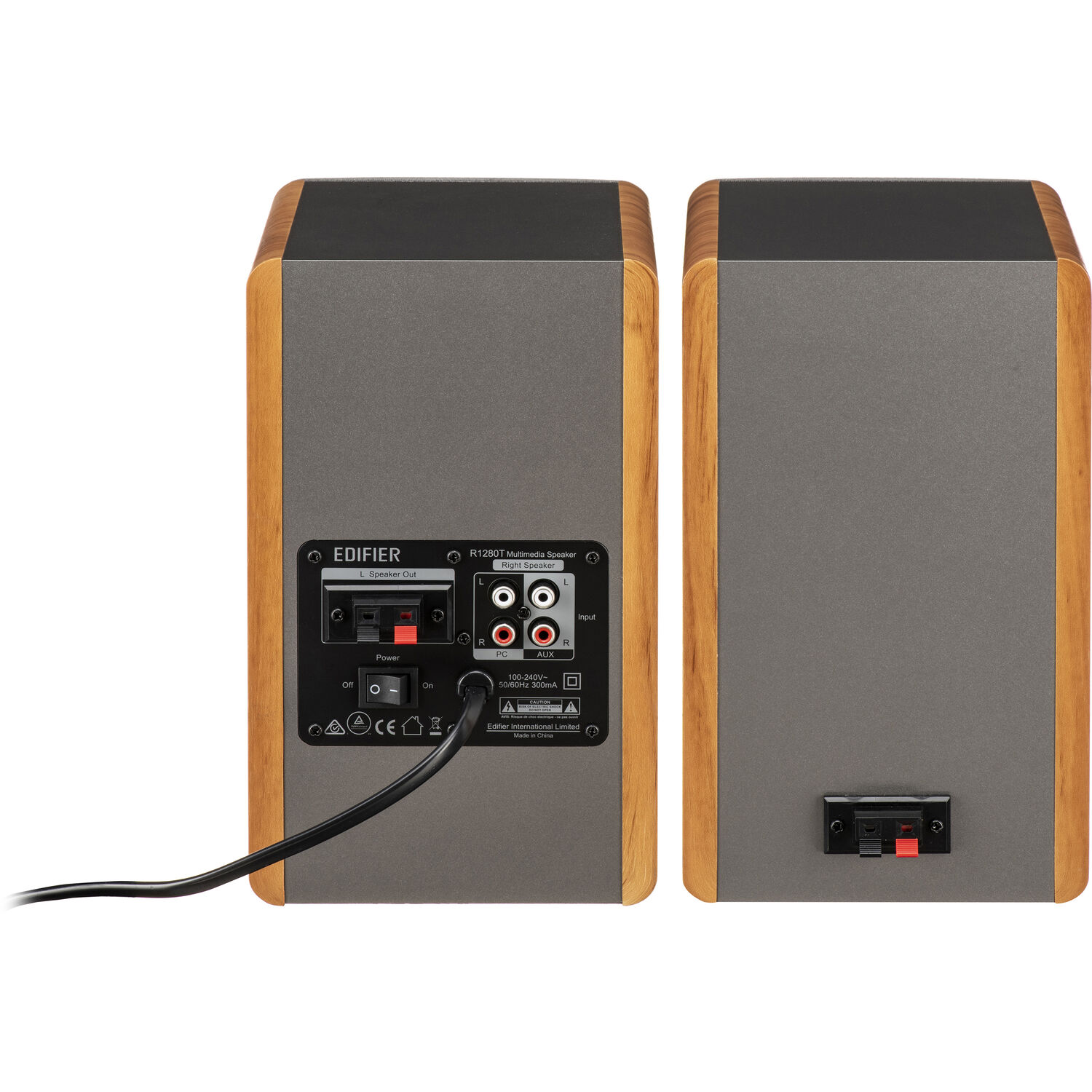

As for what I am connecting I am only running two powered book shelf speakers 5ft apart. Each unit has a 4in sub at 6oms and a 0.5in tweeter at 4oms with clamp (no terminal) style connectors. The are model R1280T from Edifier

The wire is going in a wire hider running along the back of the shelf, I have my speakers on so the color don't matter to me at all. Yes I am sure they are just bare wire clamp style connectors have a look at the pic I found online of the back of my speakers (I am to lazy to climb up and take one my self lol ) And I appreciate the suggestions but your both forgetting I am in Canada and your linking Amazon.com not Amazon.ca :)
Those are Active speakers and should be connected with RCA cables and NOT speaker wire. They do have speaker terminals, but they will be very much second best and it won't matter what wire you use, as it will be a high impedance connection.
You do not need an amp to drive those. They can be driven from any device with RCA outs, and that is the best way to drive them,.
