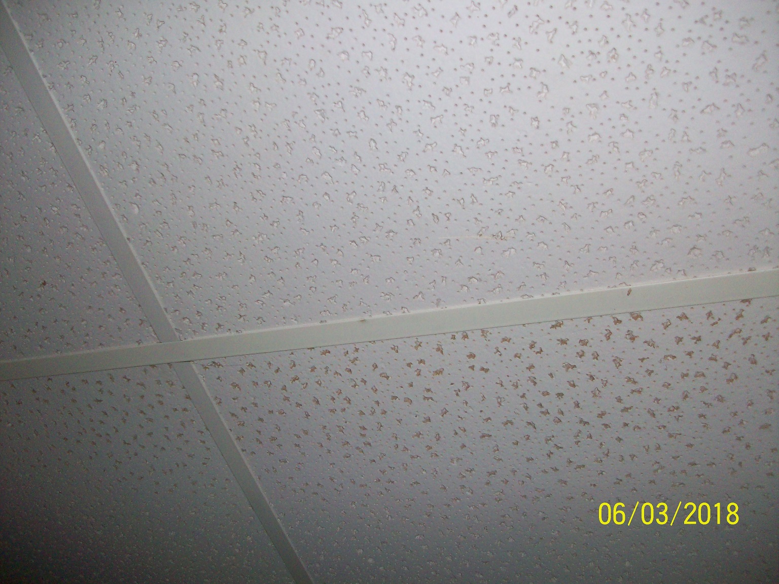

Do you think this tile ceiling I have is bad for sound? There is nothing above them just the upstairs floor. No insulation or anything. The walls are particle board...
Actually, it's not bad, but insulation would be even better. They actually call that an "acoustic" ceiling and is actually used for sound control in large commercial spaces. Especially where a lot of the mechanicals are stashed above it, like they are in many basements. I mean, can you hear your upstairs plumbing or air ducts through the ceiling?
So if I ran insulation on top of the tiles it would sound better? Would poly fill work? Would poly fill be cheaper? No cant hear air ducts or plumbing
For controlling ambient sound and speaking, but definitely not for loud music, sound effects and dialog- that stuff is useless above 85dB for mid-range and it does nothing for bass unless it's thicker, heavier and possibly backed up by fiberglass batts.
You don't want to use poly-fill. It's flammable and the smoke is noxious. Think like a fire- what materials won't burn?
That's why I said, "not bad" and certainly better than exposed floor joists and mechanicals. You would notice an improvement with the addition of the grid ceiling. Is also why I said; "insulation would be even better." Just have to make sure the ceiling was installed professionally and there are enough suspension wires. I used to install those ceilings for a living, along with metal framing, insulation and drywall. I spent a year installing sound (really horrible stuff) blankets on commercial buildings such as hospitals. I actually worked for a company called "Sound Control" installing drywall and resilient (R-channel) channel for sound proofing.
So what should I put up there? Regular insulation? The kind with one side paper the other side insulation? And just lay it right on the tiles?
Thanks for the link! Shouldn't be too hard. First i'm gonna paint the tiles a matte black for the projector before I add insulation.
