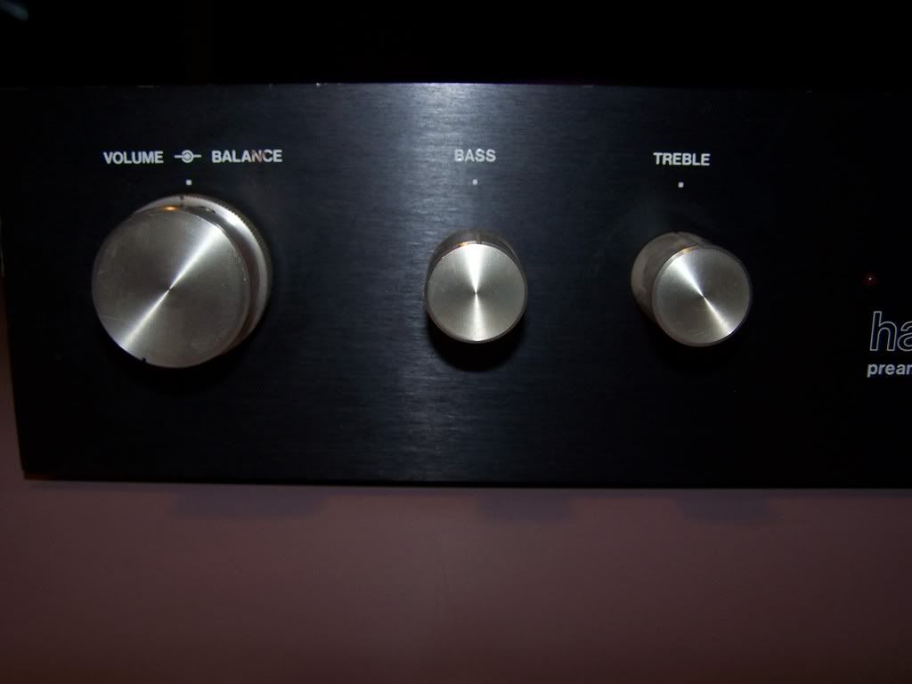

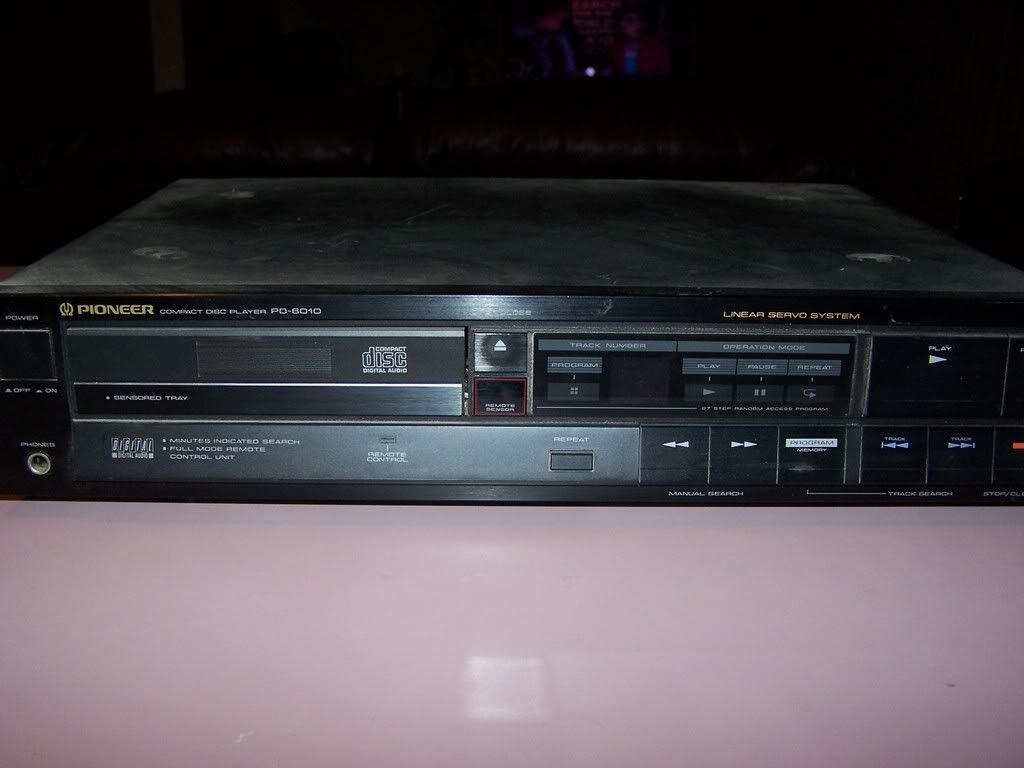

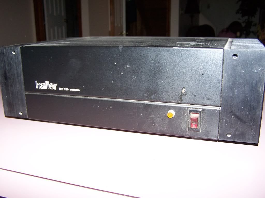

Hi everyone. I'm new here and I was recently given a lot of vintage equipment. I got a Hafler dh-101 preamp, 2 hafler dh-200 amps, a nad 4020a radio tuner, a pioneer pd-6010 cd player, a teac a-510 tape deck, 2 infinity rsa (that was the only writing on the speakers so i'm guessing that this is the part number), and 2 big polk audio speakers with what looks like a crossover on top of them. All of the stuff was supposed to have been used in a doctors house but I don't know how it was hooked up.
My first question is are these parts quality items? I'm only 18 and i'm pretty new to home audio stuff. Are any of these rare or worth anything? I don't plan on selling them I was just wondering if I should keep my friends away from them. Also, does anyone have any tips on wiring all of this? The only thing that is throwing me off if the note on the amps that says they are bridged. It says to use the two red connectors but i'm not sure which is positive and negative.

The best of it is the Haffler gear. That is comparable to current gear.

The CD player will sound fine, but it is of a generation that will not play CD R or CD RW.

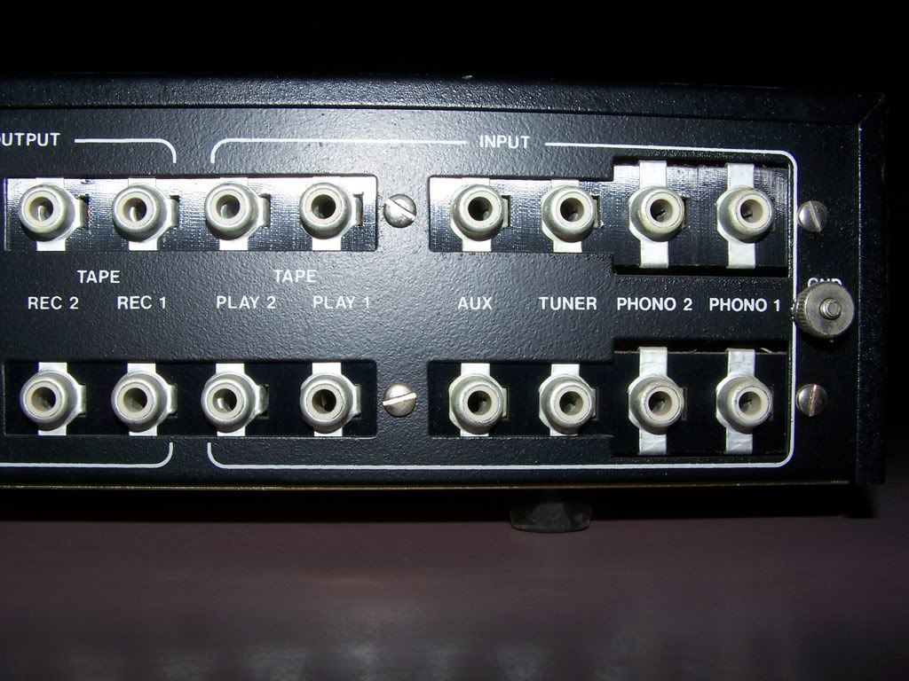

Connect the antenna to the appropriate input. Coax to the coax connector. If is flat cable to the 300 ohm. Connect the left and right outputs to the preamp tuner input.
If you plan to use the cassette deck connect tape out to tape in on the preamp and tape in to tape out on the preamp. Use the tape 1 inputs and outputs
Connect the CD outputs to AUX input on the preamp.
Now connect the pre amp outputs to the input of the amps, one for each channel.
Now the speakers. The amps are bridged, so connect NOTHING to the black negative terminals. If you do you will blow it instantly.
One red is positive and the other red negative. It does not matter which, and I can't tell you. Just make sure you connect the same terminal on each amp to a positive on a speaker and the same terminal on each amp to a negative on a speaker.
Check all connections. If everything is OK, plug in, switch on and see what happens.

Those Polks are very cool, but be careful with them. Be sure you don't wire this stuff up incorrectly, as it may be the end for the speakers or amplifiers.
Regarding the CD player, it may be old enough (and more than likely is) that will read CD-Rs. My mid-80's Magnavox CD players have no problems with CD-Rs, I haven't tried CD-RWs so I can't comment on that. I knew someone that had a Pioneer similar to that one that also played CD-Rs, but it stopped working from abuse (the owner was very hard on it, I saved one of the Magnavox from them).

Ok I understand how to hook up the speakers to the amp but how do i connect the preamp to the amp? Do i run both left and right coax cables to each amp or just one for the left side and one for the right side?
Thanks for the information guys. I don't plan on using the tape deck because i don't have any tapes. I do have the cover for the speakers but i just didn't have them on for the pictures.
One from left out to one amp and the right to the other amp. You do however need to make sure both inputs of each amp are connected. In other words the left channel needs to be connected to both channels of amp one, and the right to both channels of amp 2.

Ok thats what i thought i just wasn't sure. Thanks for the help. I'll get this hoked up and let you know how it sounds.
I'm sorry I did not make that part of the hookup clear in my original post. By the way, it may well be the inputs are already connected by the individual who bridged the amp. If you have a test meter you can check. Likely the left and right inputs on each amp are already connected, but obviously I can not be certain.
