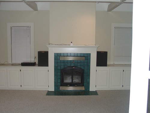

I am moved into a new (old) house that has this really neat room that I think has lots of HT potential. I have some Logitech z5500s (shut up!) that will work for now for sound, but there is no obvious place for a TV. Have a look, the pictures are from eye level (5'8")

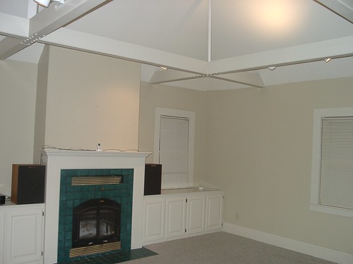

The room is 18' x 17' with a roof that peaks at around 20 feet. The beams are about 10 feet off the ground and form a rectangle.
There are 2 problems: First, I will need something that will be low profile. I'm thinking about a projector system or a flat screen plasma or LCD. I also need it to be relatively cheap, nothing above $2000.
Second, where would I put it? The room really focuses around the fireplace, maybe above the fireplace? How much would that mess up sight lines if you are having to look up a bit to watch movies an TV?

The projector could be set on the beams up high, which would give it a very low profile. The beam opposite of the fireplace is about 10 feet in the air and 11 feet from the fireplace. Is this enough distance to project a good image?

I'm counting no less than 3 windows in that room, and unless none of them lead outside, front projection is not a first step ideal. Unless you plan to spend hundreds+ $$$ making sure that there is ZERO light in the room.
To me, it is an ideal room for a plasma over the fireplace. There are pleny of 42" plasmas that can be had at or below $2K. All you need with it is a plasma mount that tilts down a bit towards the viewing area and you are good to go.
That is the first thing that screams out to me when I look at the room.
A front projector demands darkness. So, you either live in a cave to make it your primary viewing source, or you add the projector as a secondary viewing device. Yes, front projection is totally killer, but it is definitely not an ideal primary viewing device in that room.
As well, the Z4 has some brightness issues that basically force it into a totally dark room. The AE900 has a fair bit more brightness that less than ideal rooms can utilize. But, this room is a good deal less than 'less than ideal' ;)
Go plasma... LCD works as well, but will cost you more for the same size typically.
