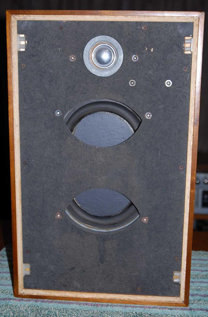

What is the impact of hiding the B139 in the Kef Concord?
surv1v0r
If you have a look at the Kef Concord from the late 1960s, about half of the B139 seems to be discreetly concealed:
Why would Kef do this?
What effect would it have on the sound output?
I am not really interested in the qualities of the speaker as a whole, I am aware that the B139 is only effective up to about 800Hz and that the T15 isn't really likely to cope adequately from there on up. I just can't understand the logic behind hiding half of the bass driver; particularly since in relation to this speaker, Kef say
Many otherwise fine loudspeakers at the time were ruined by their grille fabrics, which upset the frequency response ...
Kef link

A very sensible suggestion. Unfortunately I can't work out how to register on that forum, it seems that you need to email an administrator to get an Authorisation Code in order to register but it isn't clear who you email. Are you able to offer any suggestions? When I can register I will ask and will certainly post the answer(s) back here.
From elsewhere I have had suggestions that:
o It is a phase plug. Nexo uses them to this day. (Sadly, I have no idea what a phase plug is)
o That it makes the B139 act like a pair of B110s (NEXO’s revolutionary Directivity Phase Device causes an 8 inch driver, for instance, to behave as twin 4 inch drivers, with two acoustical centres spaced 5 inches apart).
I don't doubt that Kef had a very good reason to do what they did, I just wondered what it was. Kef certainly didn't do the same thing with the the very successful and popular Concerto which uses a B139, B110 and T27 so I guess that it must have something to do with the absence of a discrete mid-range driver.
I am not really interested in the qualities of the speaker as a whole, I am aware that the B139 is only effective up to about 800Hz and that the T15 isn't really likely to cope adequately from there on up. I just can't understand the logic behind hiding half of the bass driver; particularly since in relation to this speaker, Kef sayKef link

For the B139 this was a serious problem as the polystyrene starts to resonate at 1000 Hz and violently at 1200 Hz. In my view the B139 needs to be 24 db down by 800 Hz. I never cross them over above 400 Hz.
So in the KEF concord a very crude attempt was made to suppress this excess energy due to resonance. This is nothing as sophisticated as a phase plug!

So it is important to have a perspective on the times, and understand what was known and unknown, and how a crude move like partially covering a driver to muffle a resonace could be done without shame.
