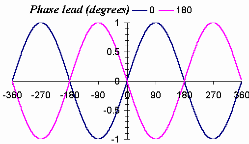

Electricity comes in direct and alternating current. The simplest example of direct current is a flashlight you connect a battery to a light and the light comes on. Alternating current varies with time ( frequency) and goes from a postive to a negative in a sinusoidal wave. See the image below:
Each different audio signal is a different frequency and the all add up to form sound.
However looking at the image above each frequecny has a total period of 360 degrees or a circle. A phase shift of 180 degrees means the waves exactly cancel each other out (the blue and violet sine waves are exactly 180 degrees out of phase)- this is the technique being using in noise cancelling headphones and nosies cancelling mufflers. In eact case a microphone picks up the original sound and then shifts the phase 180 degrees and output the shifted sound to cancel the original sound.
When you are listening to sound it is important that the speakers are in phase otherwise the sound from one speaker could cancel the sound from the other speakers.
