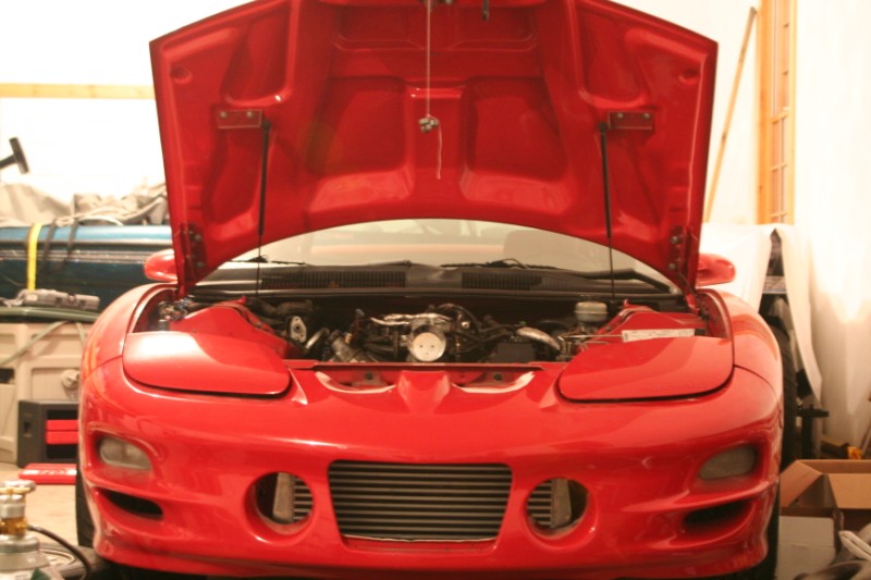

Backing it in for the last time

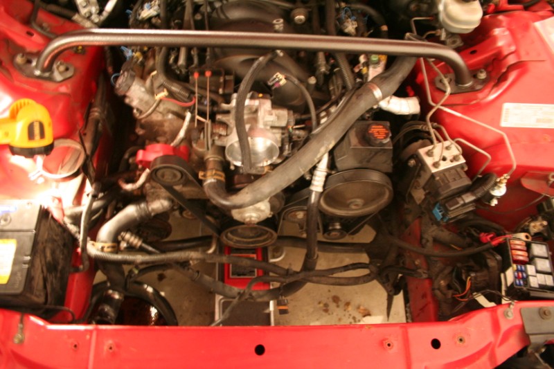

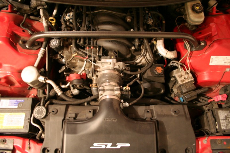

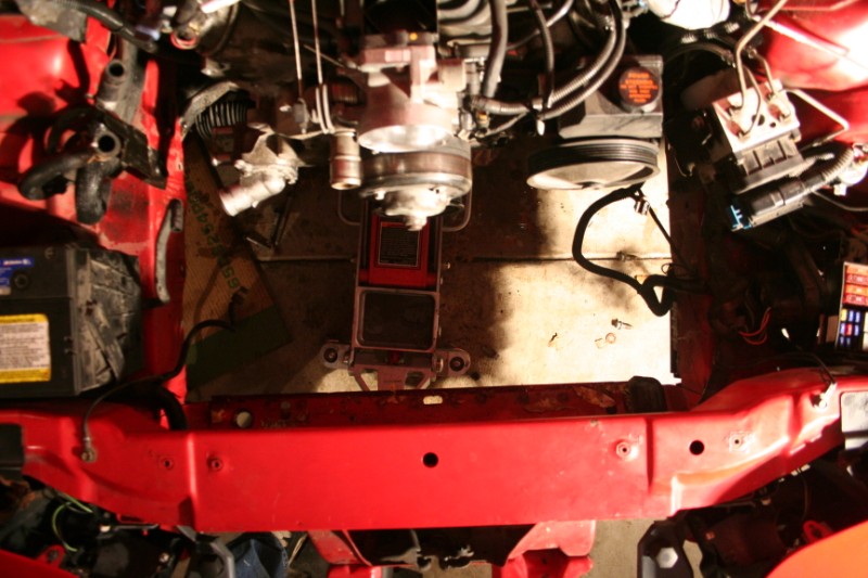

Engine bay before...

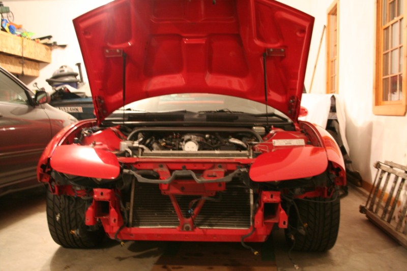

Pulling off the headers
Day 2
Bumper off (that was a pain in the ***)

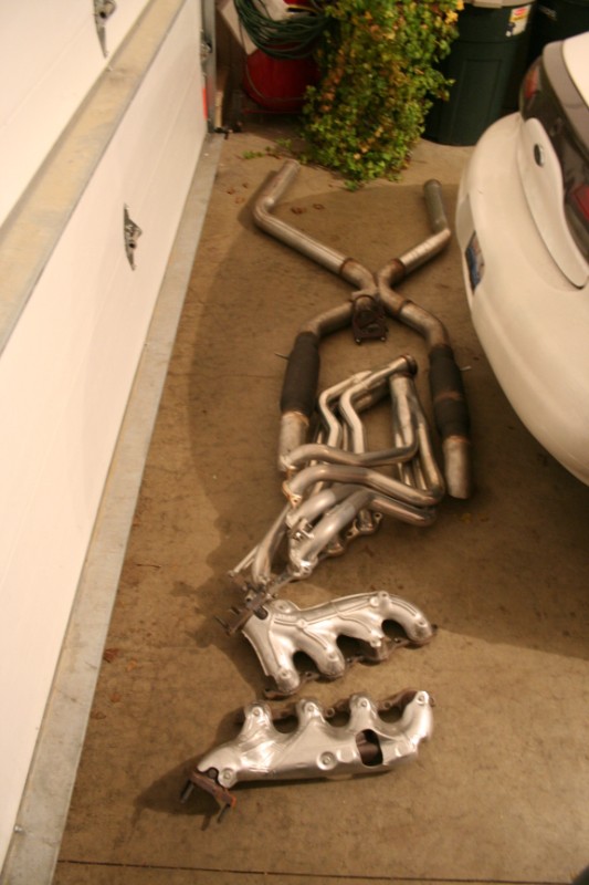

Here is the old exhaust, headers, and the new truck manifolds.

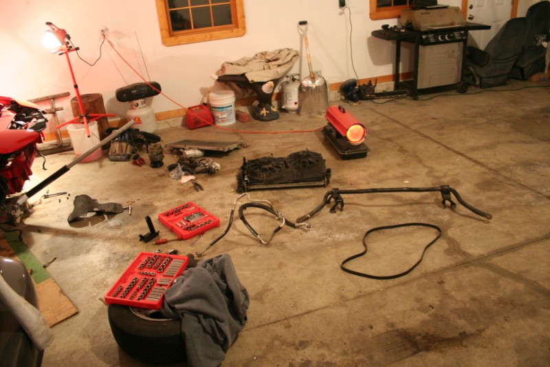

Day 3
Getting all the un-needed crap out of the way
Most of what came off, never to go back on
What we have to work with more or less

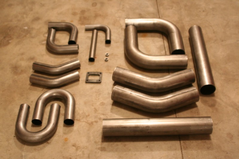

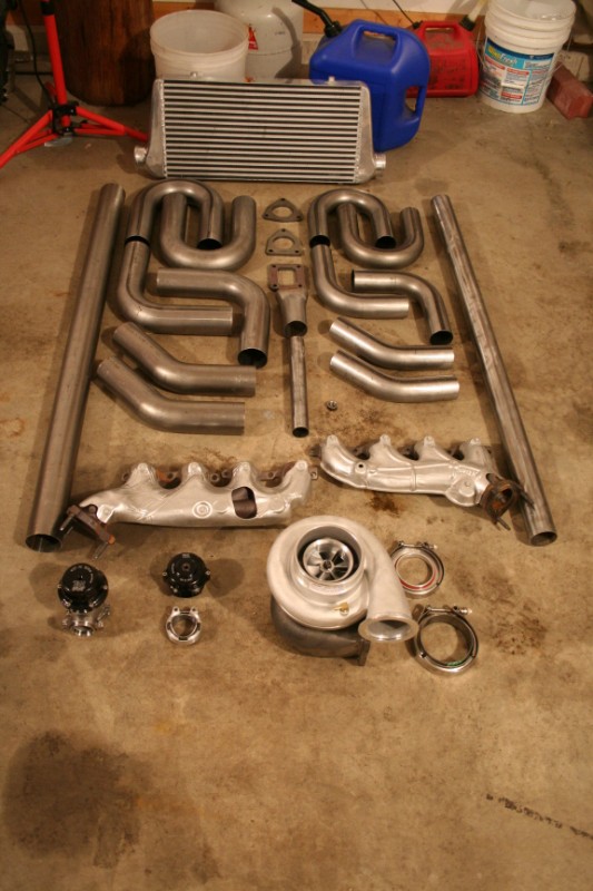

Here is the first order of pipe (2.5" and 3") The turbo, waste gate, BOV, and intercooler.
Here is the second order or pipe (more 2.5" and 4")

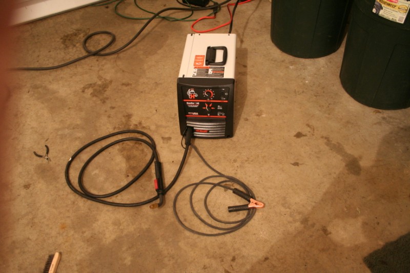

The welder (Hobart handler 140)

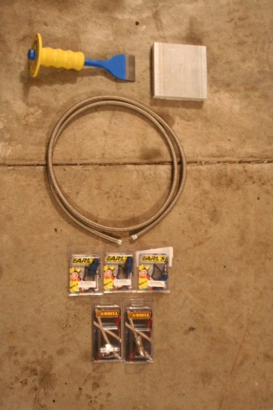

Stuff to make new power steering lines (still missing 3 fittings in this pic)
thats a block of aluminum and a mason chisel for those who are wondering. Supposedly it the best way to cut AN line, well let you know cause we need to cut alot.

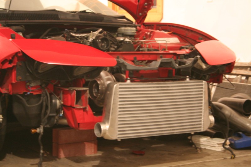

Day 4

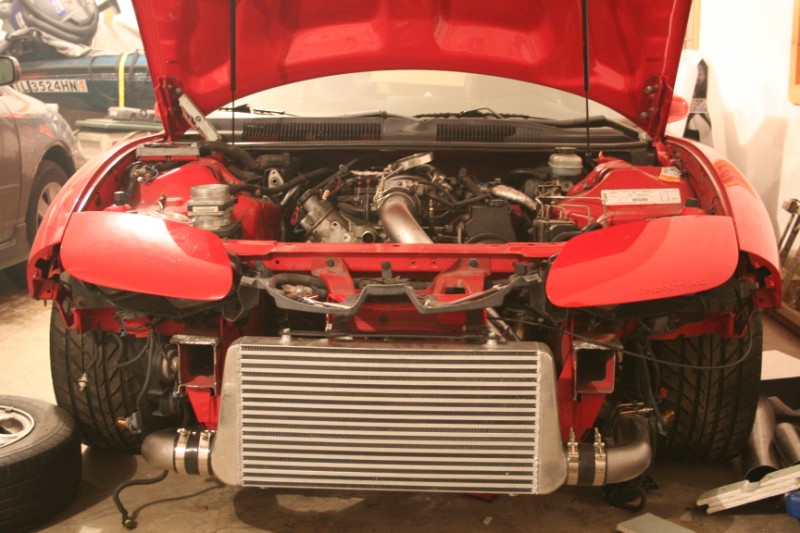

Intercooler finally mounted, and bumper mostly done.

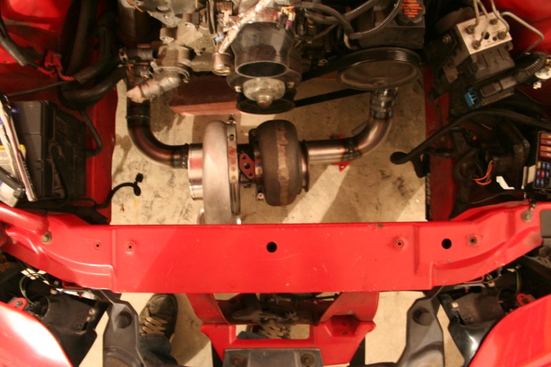

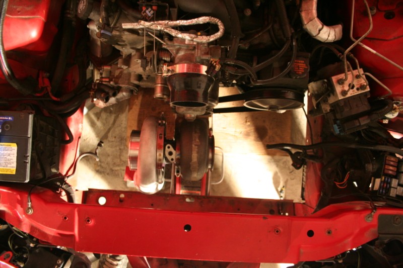

Placing the turbo (we did this alot)

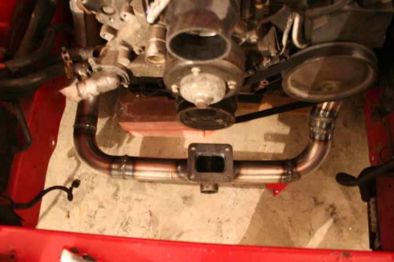

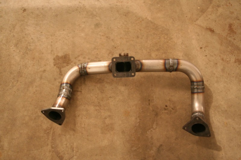

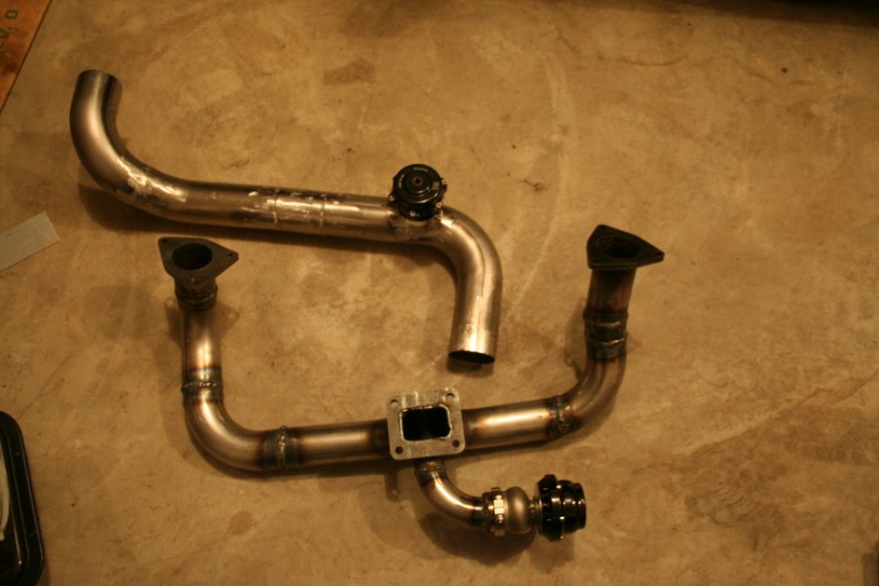

Me welding the crossover pipe
The crossover pipe after I just finished it
Crossover pipe in the car and bolted on for the first time

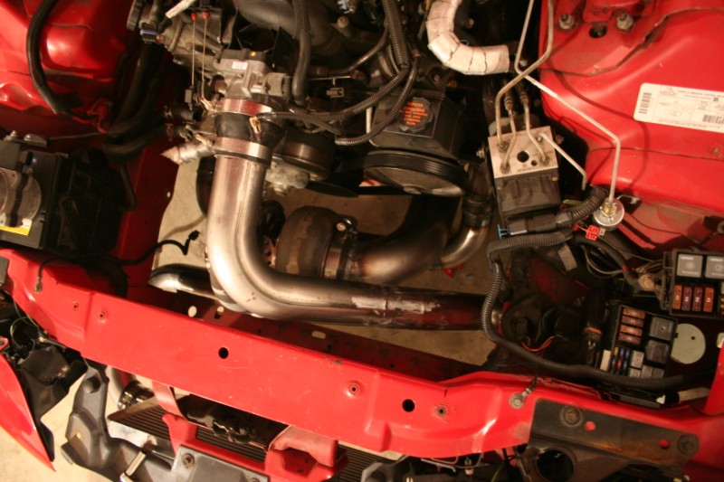

Turbo bolted on for the first time

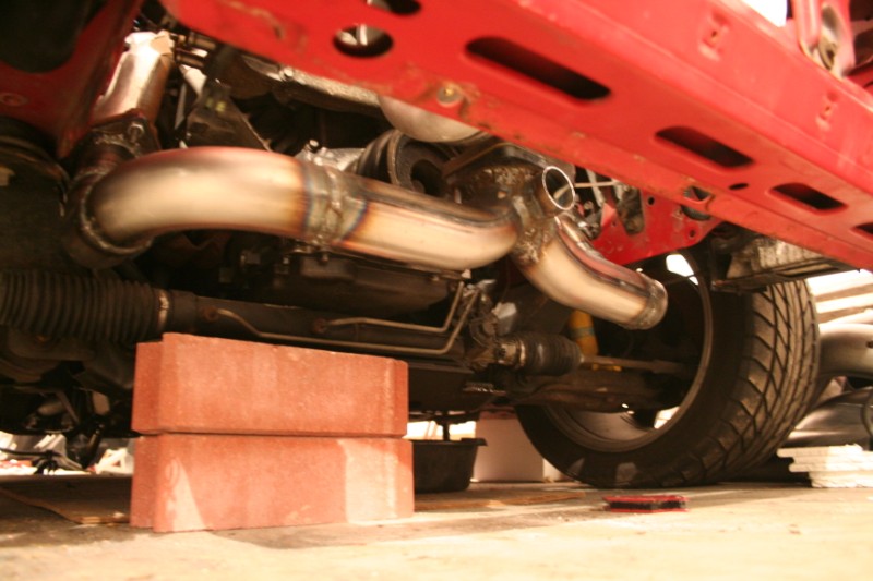

Bottom shot, to see where the wastegate is goin.

Intercooler and turbo on the car :)

Oh, and nice welding helmet!! Mine is junk. ;) I'm jealous.

I used to electrical tape and a hack saw, or a Sawzall to cut braided line.
If you don't want to spring for cutters.:)

For anyone wondering where we got the idea for cutting the AN...
http://www.youtube.com/watch?v=u1J7u8sG118
They cut it all day everyday and thats how they do it, must work. If it dosent we have all the tools for every other method mentioned and then some. Look for some new pics sunday or monday, were hoping to get the IC piping almost done (cant do all of it cause out of the turbo has to be aluminum which we cant weld) and lower intercooler brackets at least. Radiator and other parts came in the other day, so well see if we start on that or not.

OK, we were back at it again last night. We got all the intercooler piping made, and the start of the downpipe. For the intercooler pipe we still need to decide where were gonna put the MAF, and the blow off valve, and install them. Still need to brace the piping as well, and probably have it bead rolled where there are couplers. On the turbo, its a aluminum flange, so that has to get welded to a aluminum 90 as well. The downpipe is just what you see in the pics so far. Because of placement, we have to run the downpipe under the K-Member. As I'm sure you could imagine 4" pipe under the motor doesn't give alot of clearance, so a 4" oval pipe is gonna clear the K-Member. Once that gets made then well finish the exhaust/downpipe, the "muffler" is already here as well as the piping we need (minus the custom made oval pipe)
All that left for us to do is mount the new Griffin radiator (Thats next weeks project) then its all small stuff. We need to install fuel pump, injectors, plugs, boost controller, make some lines (oil for the turbo, radiator, and power steering) mount the alternator and the belt, rewire the alternator, wire linelock, and wire gauges. Thats about it, there may be a lil more but nothing really major.
On to pics :D
There is more room between the piping then it looks like in the pics. The downpipe and the crossover pipe are close, but it is a 4" downpipe :) We decided to grind down the welds on the IC piping so that it will look like 1 pipe when its all coated, that and my welds aren't nice enough yet (but getting better)

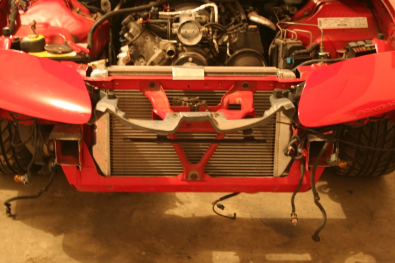

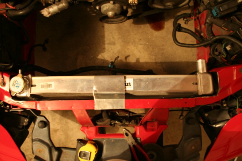

Ok time for a update. We got the radiator support cut, and the radiator mounted. I also made some lower radiator brackets, mounted the blowoff valve, waste gate, and 2 of the O2 bungs. Once we make the upper radiator support were done with fab work, and its on to all the small things.
