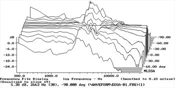

So waveguides have poor off-axis response, eh? My initial reaction was similar to yous, though I also took away that they allow for a high sensitivity, thus are more dynamic than your typical dome or ribbon based speakers and can be played very loud without distortion or breakup.
Not all waveguides have poor off-axis response, but this is a typical symptom of them. The manufacturer seems to point out the high directivity on their site though. In rare cases, such as the Behringer 2030p, the polar response is actually aided by the waveguide.

While I agree with the latter statement, I think there is a lot of technology and research involved in waveguide tech. I've never heard any offerings with this technology implemented, but I'd like to. Based on what I've read this technology gives a more realistic presentation, though that is highly subjective, of course.
Loudspeaker preference has been shown to be far from a highly subjective subject. Many of the papers I have cited in this thread alone deal directly with.
However, I wonder what the off-axis FR looks like...
The waveguide polar response would exhibit sever off-axis drop off similar to this:
