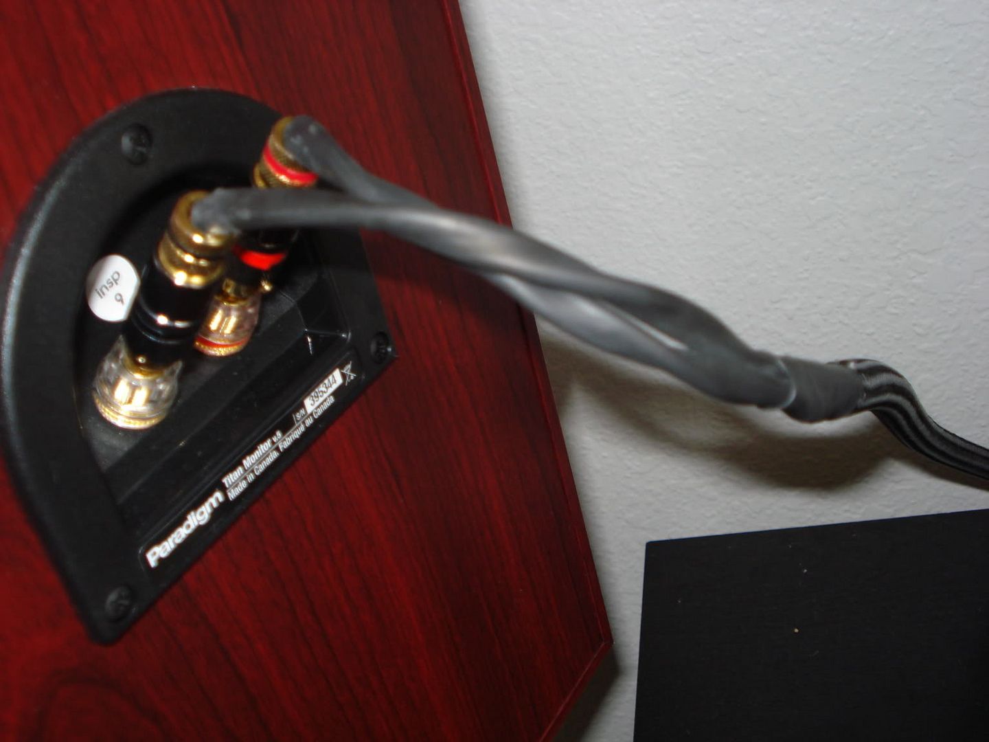

I took 20ft of Blue Jeans Cable quad canares raw:
1) Cut them in half.
2) Splice them up and tie the red and black leads together.
3) Cover it with some nice looking TechFlex from Partsexpress.com
4) Heatshrink
5) GLS locking banana plugs.
6) ???
7) Profit.
Sexy.
Cost me maybe total $30 for two pairs of solid DIY 10ft speaker cables thats lasted me two years so far and twenty speakers later.
