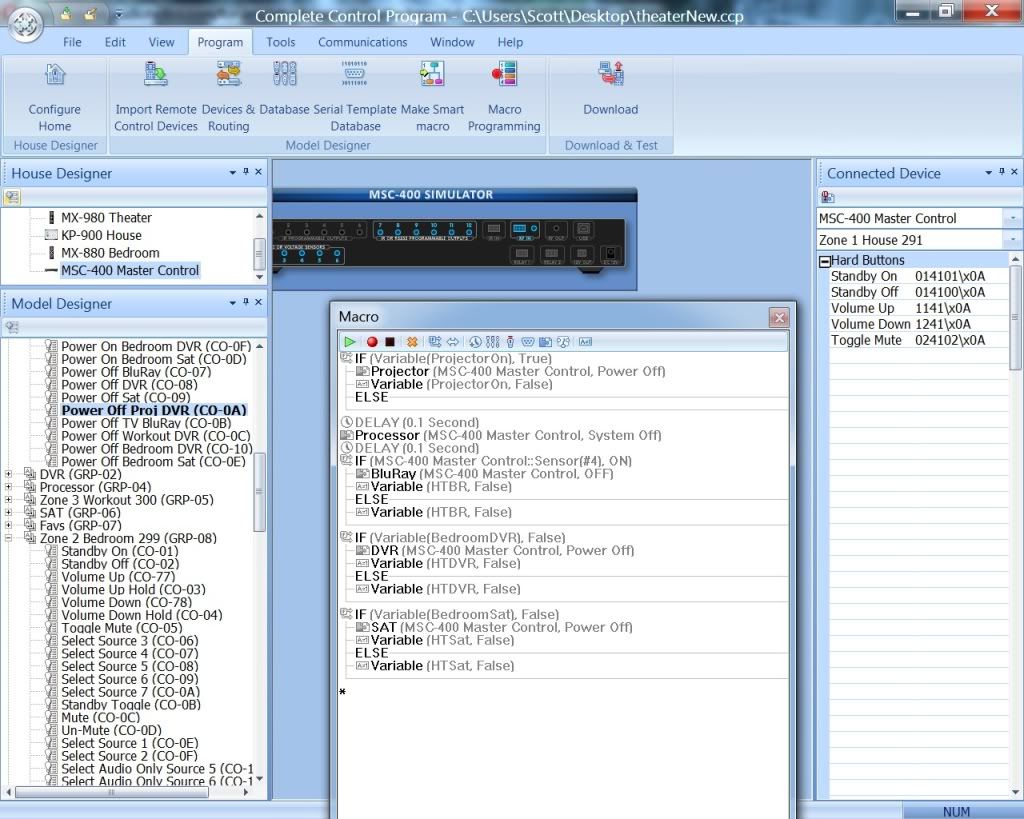

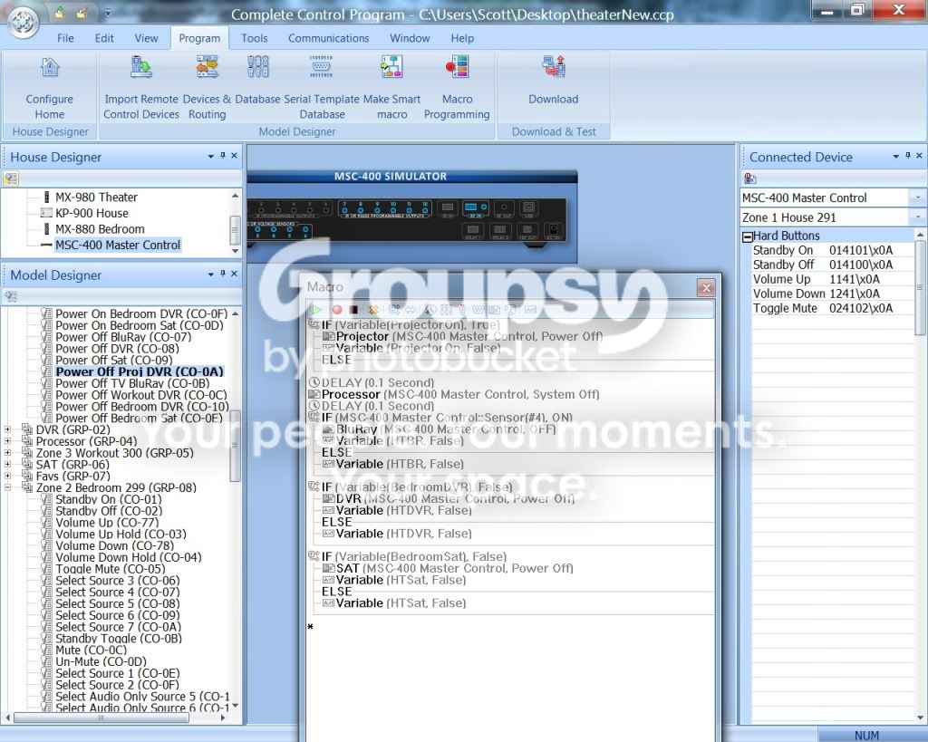

The latest system is now all URC. It consists of a MSC-400 master control unit, MX-980 remote for the theater and workout zones, MX-880 remote for the bedroom zone and a KP-900 keypad for the house zone. This has been a major step up. I am still using the Integra MZA 4.7 receiver but it is now controlled via RS232 and not from the IR keypads.
The good:
1) Full RF from remotes to MSC-400 so no direct IR.
2) RS232 control of Processor, MZA and sat boxes. Sat boxes can be controlled via a USB to RS232 adaptor so no more IR.
3) All macros are stored on the MSC so it just gets a trigger command from the remote and it sends RS232 or IR command directly to sources.
4) Full graphics control of the MX-980 remote so it will look and function like I want.
5) One software program and file to program entire system. Add or remove a source is much simpler.
6) I can read power and video status so I can control macros based on the state of the source.
7) Variables can be used to track sources through multiple zones so shared sources will not get powered down while someone else is watching/listening.
The bad:
1) No two-way control. I still need my mini lcd to view tracks and cannot feed that data directly to the remote.
2) Cost.

You cant tell me that Dawg wouldn't like to play around with this software..
BTW Craig, have you started taking the laptop to the bathroom for private time programming:eek: I think for being new to the software your making huge strides. I know a few guys that still use the stand alone editors:confused:
