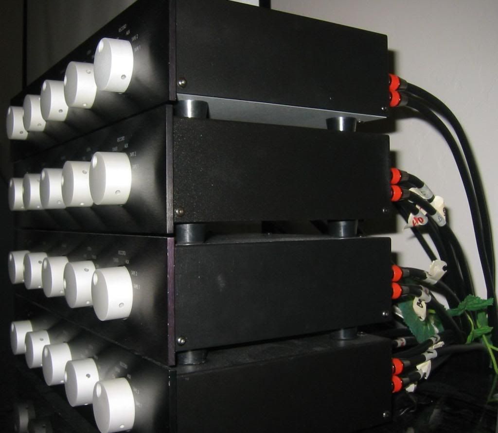

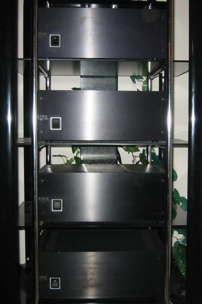

I do own a $7500 Denon AVP-A1HDCI pre-pro and 4 ATI amps. :D
