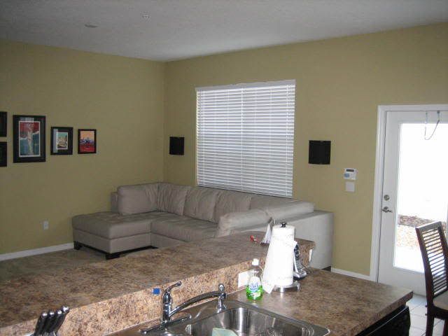

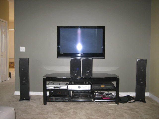

This is my home theater and primary listening area. The room opens up to the nook and kitchen area, about 3000 cubic feet. Does anyone have any wife approved acoustic treatments for an area like this? Something that can be painted to match or contrast??!! The room is missing a the subwoofer which is the next thing on the list to buy. The window behind the sectional has blinds in front of it. Anything I can put behind the blinds to prevent the sound from reflecting off of the window? The other problem is the tv. I think I mounted it to low. Now part of the tv is just under the center channel speakers. Any help!!!!!!!!!!!!!! Thanks!!

If you don't want to re hang your display I suggest laying the center speakers on their sides and see how that sounds. It probably will be fine that way. Once you get your sub the first room treatment I would get is a bass trap in the right front corner. I am not sure it will pass the WAF, but they are offered in different colors and the one I have matches the color of the wall which helps it to blend into the backround

Something on the front wall behind the speakers will help - not to mention something on the side wall on the right. If you're handy, you can DIY some small panels and get special paper backed cloth that you can use an ink jet printer on to do custom pics that are wife friendly.
As for better sound, a couple of suggestions.
- Get the seating away from the back wall a couple of feet if at all possible and put some thick absorbtion on the floor behind it.
- Lose one of the center speakers. You should never have a pair for centers like that. Use one on it's side even though they're not designed that way - it will work much better.
- For the windows, you can use a thick, full hung curtain to provide some additional absorbtion and minimize reflections off the back window.

You can use wool blanket on the window. Cheers.

Do not use blankets for acoustic control. It's high frequency only. If you have to deal with curtains, get something thick and something that will hang full even when closed. That will provide a much more broadband solution and match much better with acoustic panels on the other side.
