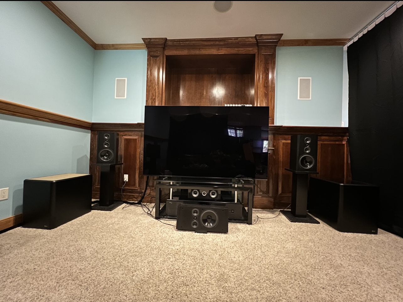

I am piecing together a home theater and have the following gear:
Pioneer LX701 AVR set up 7.2.4
Sony A80J 77 inch OLED
Triad LCR front and center
Two Muse Model 170s monoblock for left and right.
Outlaw LFM-1 Plus left sub
Outlaw LFM-1 EX right sub
Gershman Acoustics X-1 surround
Pinnacle BD-500 rear surround
Canton rear elevation
Unknown in-wall front elevation
NAD 2600A amp for center channel
I have a B&K sound meter, so I could do measurements.
I also have a low cost Sony measurement mic that I have used for the Pioneer auto-cal. Is there some software I can use with a laptop to do sound sweeps and find out if I have a desirable SPL for bass at low-distortion?
Or even an iPhone app that will cast sound to the system and use the iPhone mic to measure?

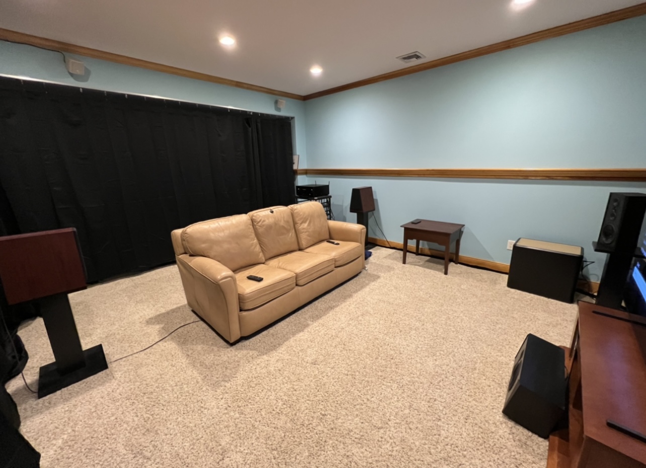

My theater is 2150 cubic feet, but that is only using curtain dividers and in a larger room that is a total of 7500 cubic feet. Not sure if that means my “room size” is 2150 or 7500 cubic feet?
The subs are 10 feet from the main listening position.
I realize I need to test to be sure, and I will get to that, but are these subs likely adequate or should I order 1 or 2 more of something like an SVS or Hsu VTF-2 MK5?

Hmm... I'm not familiar with either sub, but the EX looks to be the more capable of the 2. In general we recommend matching subs when going dual otherwise you're limited to the capabilities of the weaker sub.
The room and any space open to it do count toward room volume. You don't necessarily have to pressurize the entire space, but it does factor in. Spec-wise a pair of EX's might just do the trick. Right now you have a mismatch.
I'm curious what you have going on for your center channel. In your pic there's a speaker on the floor in front of the tv, but looks like you have another one, a center channel, behind the tv? You might have some opportunity for improvement there as well.
*Edit: on second glance I see those subs have variable tuning and list 2 different fr's. They're closer in performance than I first thought. How does it all sound? Are you lacking for bass?

Only the one center speaker is active. The smaller Pinnacle above it is not hooked up.
I got those two speaker sets for free as they came with the house as they were discovered behind built in screens in the walls that the previous owner forgot. I guess her husband put them it and then she divorced him and she didn’t know to take them out. All made in USA good stuff.
The smaller sub is in a corner wall so that helps. My Pioneer auto cal has them matched.
They sound good, but I may not know what I am missing.

Yeah, when I looked closer at the specs I realized the 2 subs do have similar fr's and should play pretty well together. As far as whether or not you're missing anything is really hard to say unless we can see some measurements or be there to hear it in person. I think, properly set up, those subs might just be adequate but wouldn't hurt to get something more powerful, or add another one or 2 of the same.
Let's see who else pops in for some more opinions tho before you run out and spend anything. Depending on how far down the rabbit hole you wanna go, you could very well benefit getting a calibrated mic and REW so you can take some measurements to see where things are at right now. A mic will cost you about 80 bucks and REW is free, but there's a bit of a learning curve so it's not for everyone. It just depends on how serious you wanna get about dialing your system in. It really helped me a lot, but I'm a tweaker so that kinda thing is right up my alley.
So the center channel behind the tv is not hooked up and you're using the one on the floor in front? I think you might notice an improvement in dialogue if you get it up off the floor and get the tweeter closer to ear height or angled up toward the listening position.

The cubic foot size of your room is typically specified for a "sealed" room, but it will also depend on the material of your curtains. Are they made of heavy velvet fabric?
