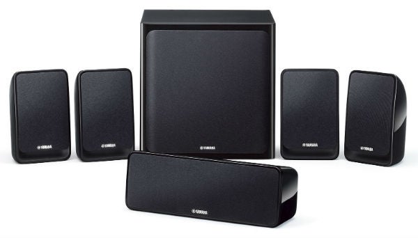

Thats the set:
I intent to replace all of it, as I already have 2 self build stereo speakers.
The subwoofer sounds useable.

Thats the set:
