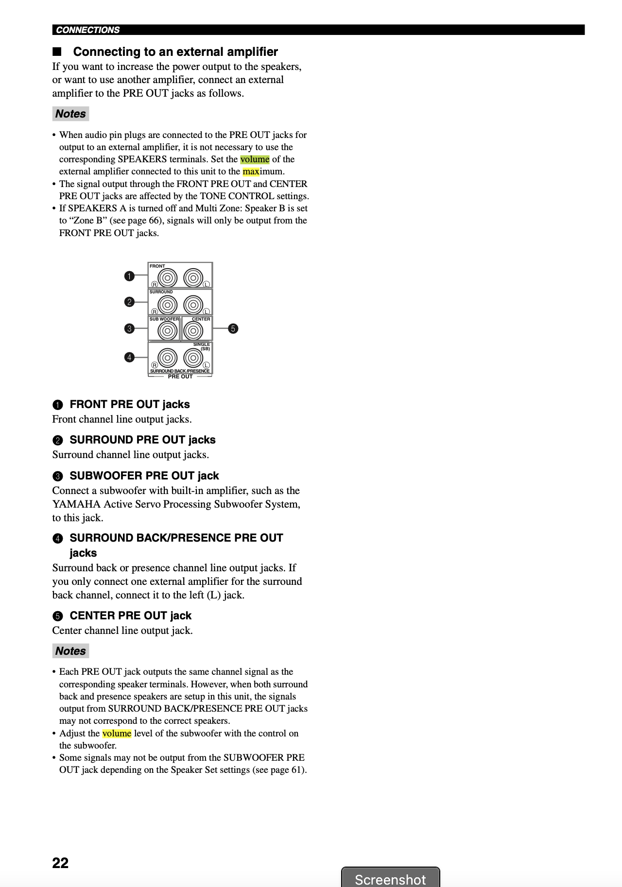

They actually mention max volume regarding the 2500 pre outs but didn't mention it about the 1200 pre outs.
Wonder why they would say simply max out the gains when using an external amp like that. Confident their pre-out levels are so low that it wouldn't be a problem ? :)
