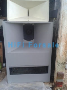

For the benefit of other members this is what we are talking about here.
This unique sound comes from driving large paper fiber woofers close to break up and combining it biamped with a large multi cell sectoral horn. Preferable the system is biamped as you are doing.
If you find you do need a center then a speaker would have to be custom designed and built. However it is still going to be a fairly big speaker. That is why I ask how much space you have.

Thank you for posting the pictures. The only difference is I have the MR2 594 horns. Think they are called Manta-ray?

The A5 is from the sixties. Altec developed the Mantaray constant directivity horns in the seventies. I have checked it through and you do have the correct Mantaray horn for the A5.
So this is your speaker.
If you don't have room for one of those horns for a center speaker, then I would forget about using a center. If you do have room, then I would look for and try and purchase another of those Mantaray horns.

The 1st pictures you posted are exactly what my bottoms look like, with the bold Altec grills. I think the bottom port may be bigger than in this picture?
I'm pretty sure the previous owner swapped the horns to the Mantaray. Also, the horns are the matching grey. I think you are right that the bottom was from the 60's and the horns were 70's.
