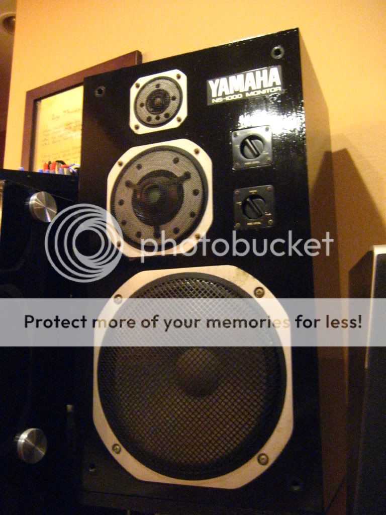

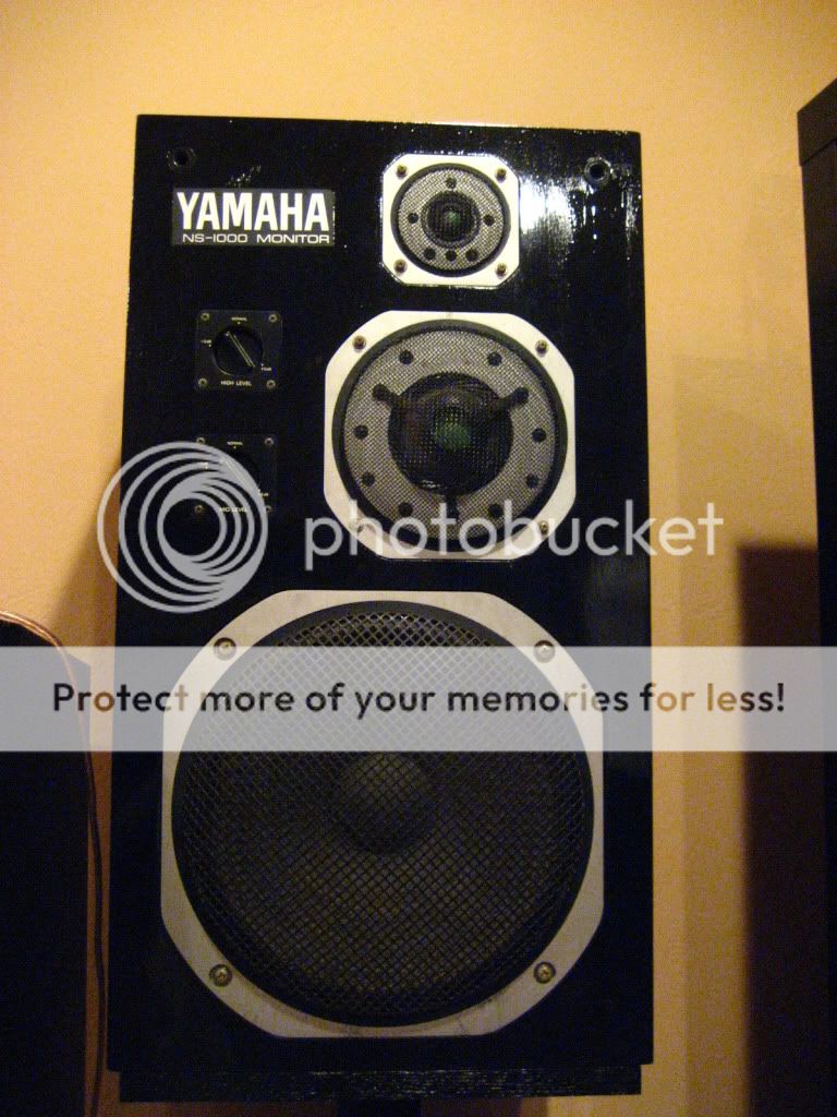

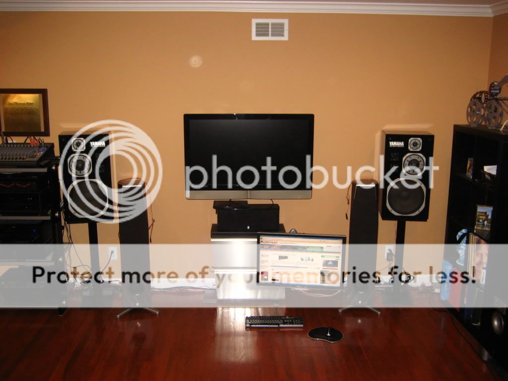

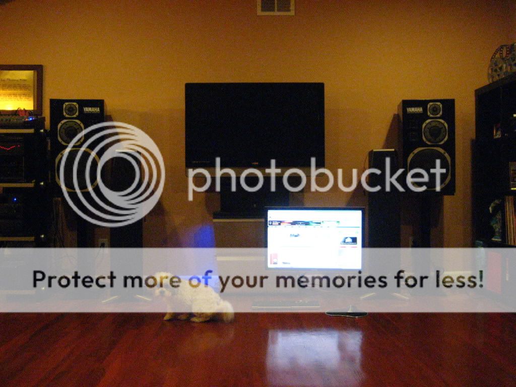

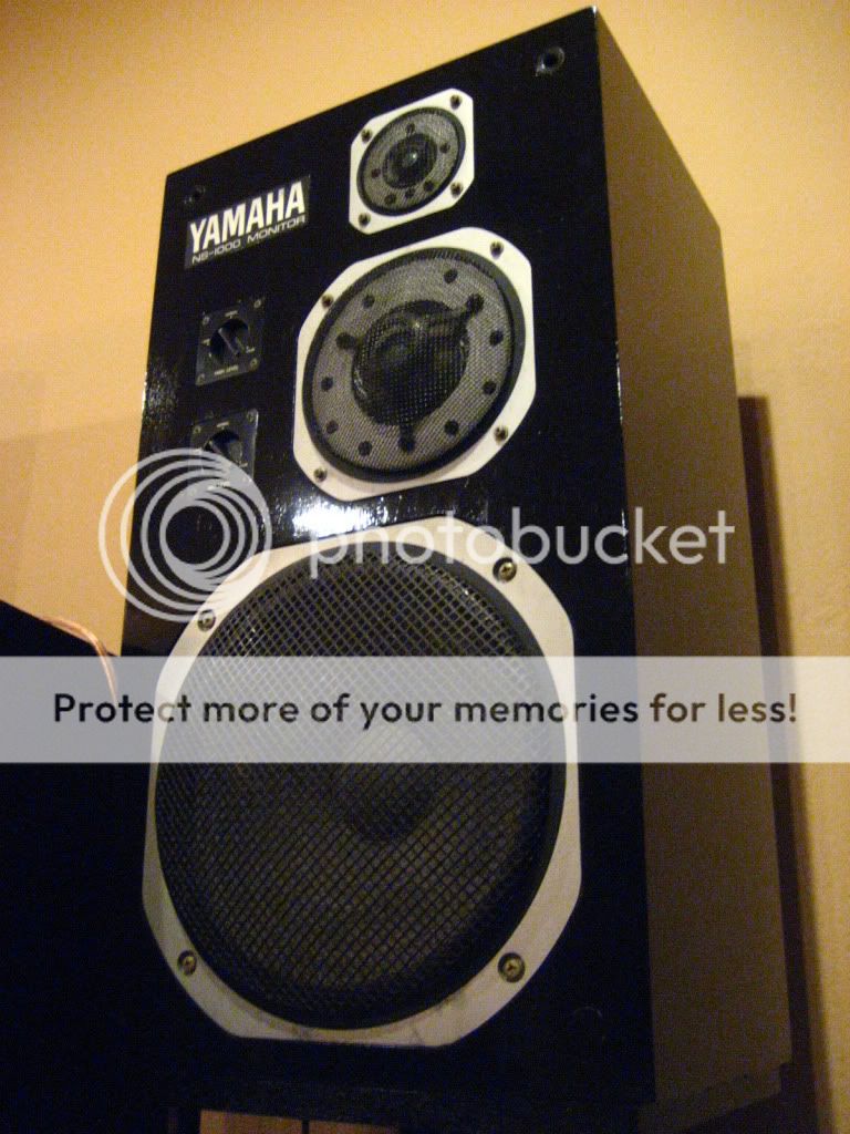

Here we go...
I did buy the TV mount, longer HDMI, DVI cables to put them in-wall. And here we go, the YAMAHA NS-1000M (stay true to the brand). I got the stands with them. I did re-finished them, the job was decent, not perfect. Black stain with Polyurethane.. Once again, thanks all for help and advices....
