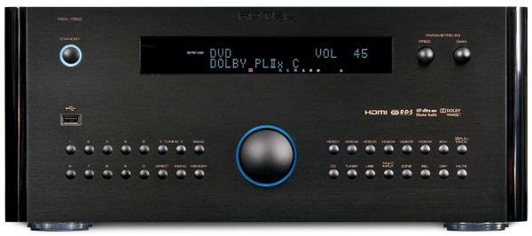

So my Rotel won't pass through 4k video on HDMI..... That kinda started this whole bug of 'lets look at a total upgrade".... I kinda thought to refine my two channel and HT by more power and mono component electronics.

I'm sure I can resolve the Rotel 4k passthrough by purchasing an AVR. Might start there and keep the Rotel working the speakers as normal.... If I buy the Anthem AVM 70, I think that will work for the processing and should be able to keep using the Rotel.... I think......

If you're running HDMI from the PC to the Rotel, then the Rotel should be doing the D.A.C. and the PC DAC is not involved, unless you are also running line level audio out from the PC to the Rotel. The Rotel will likely have a better DAC unless you purchased a dedicated audio card for the PC for that purpose. I ran Plex on my PC to a PS3 connected to the AVR but changed to a Roon Server for audio with a Raspberry Pi running the Roon client software feeding the AVR via HDMI, since the PC is in another room. You would just need the Roon Server on your PC. The theory behind Roon is pretty interesting although the improvement in audio was hard to detect on my system. What I like is the gapless playback, controlling Roon with my cell phone, and the excellent way that Roon manages to randomly select music in similar genres. I also went through the long process of re-ripping my CD collection to go lossless, but it was well worth it. Mp3s do not play back gapless, and I find the gaps on live albums or where songs blend together to be very annoying. Roon is not cheap for a lifetime license, so I went for a one year trial but will likely get the full license later.

I see what you mean. My video card only has one HDMI output. The mobo has another HDMI output but that will be a different audio source on the PC and different brand (Nvidia vs Realtec). Not sure if that would work, never tried it.
I used to have all my HDMI inputs going directly to the Rotel on separate input channels. Then out of the Rotel via ARC to the TV. But since the Rotel won't pass 4k through the ARC now, I opted to hook all inputs to the new TV and run HDMI from the TV ARC down to the Rotel ARC. (now that I type that last sentence I'm wondering if I did that connection properly....Maybe I should move it off the ARC on the Rotel).

Whether that makes sense or not would depend on a few things. Like whether the Nvidia was 4k capable or you upgraded the graphics card the same time as the TV, and are your sources 4k? If your source material is 4k, then going direct to the TV makes sense, otherwise you would be downscaling the video to 1080p on the Rotel and then upscaling back on the TV (until you upgrade to a 4k AVR). If the source material and the Nvidia are not 4k then keeping things connected to the Rotel is fine and the TV would handle all video upscaling at the end.

What ARC does is that it allows you to use your TV as an audio source back to the AVR, even though you are feeding audio and video to the TV from the AVR. If all sources were connected to the AVR, but the TV had Netflix built in or a Roku plugged into it, ARC allows the TV to supply the Netflix audio back to the AVR without using the optical out on the TV, so one less cable. It has the added benefit of handling multi-channel audio over HDMI instead of lossy compression over optical. For all other sources it doesn't care about ARC. So ARC has nothing to do with 4k. It just allows the audio to flow both ways in one cable.
I mentioned all that because you talked about passing 4k through ARC. The two are not related. For 4k, you need to look at source material first. With a 4k TV but non-4k AVR, only the 4k sources like a 4k cable box or 4k blue-ray need to be connected to the TV. Likewise if your PC has a graphics card that outputs 4k *and* your video files are encoded in 4k, then connect to the TV (hence why you need to use the Nvidia HDMI, not the motherboard's; it has to do with the video, not the audio). If your PC is set to output 1080p, then the TV is upscaling the video and it doesn't matter if you connect to the TV or AVR. If the Nvidia is 4k capable, you have to change the display settings on the PC to match the new TV. If your video files are not 4k, then it's also a question of where you want the video upscaling to occur, on the computer or on the TV? That's probably a matter of trying both and seeing what looks better, especially with fast panning.

What I meant to say and you understood correctly.... is that my Rotel is too old and not capable of passing through a 4k signal or interpreting a 4k signal. 4K wasn't a thing yet when I bought it.... so... Using my TV as my display seems to add a bit of head scratching when I want to have good two channel and home theater....but I will figure out to hook everything up and get it to work right, or how I think is right sooner or later.
( currently I can listen to music from all 7 speakers or the Rotel can switch to 2 channel audio, which I want to improve the 2 channel audio).
