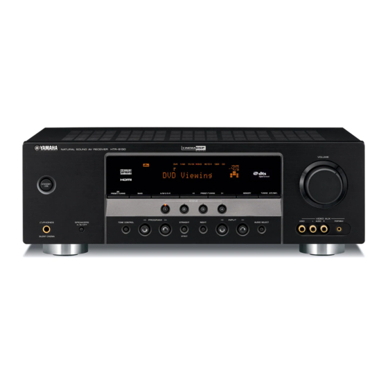

The model of the AVR I have is Yamaha HTR-6130
In general this set has put out really decent sound as a whole. Individually, the speakers lack some midtones and bass which is more than made up with the huge subwoofer.
