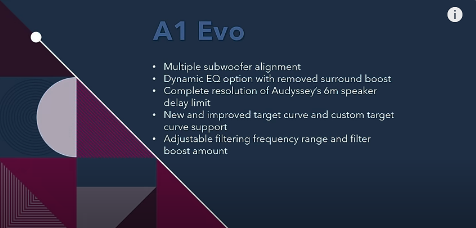

I'll skip the backstory on why I was using Toslink in the first place but for those who are still looking to override the forced Audyssey target curves and get around other unwanted limitations in the Audyssey app, I found this awesome looking free web based solution that taps into REW to clean up room corrections and get rid of various other unwanted settings that are forced otherwise. Check out this video A1 Evo
I'm not sure if there's an Audyssey One thread already or not, but the author OCA is a member here. Wonder why for a 5.1 setup there would be a difference between optical and HDMI ARC audio particularly, tho.

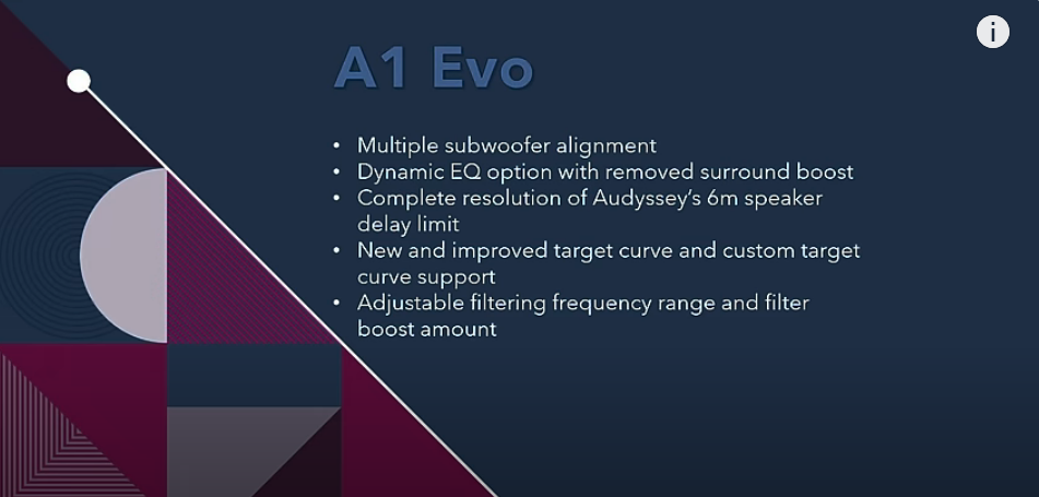

HDMI will get you lossless HD audio formats, but there shouldn't be a drastic difference is sound quality using optical.
