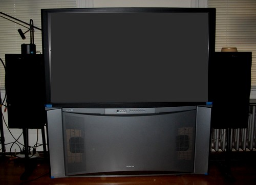

I would like to add you would be doing yourself a huge favor if you replaced the Nuance speakers. They aren't designed to sound good, but rather to sound big, forward, and look like they mean total business. They are manufactured using rather inexpensive and dated driver types (paper is a thing of the past), but they do coat them with some type of polymer to make them appear to be more than what they are.
As for the problem with the PSBs, PSB has a reputation for being power hungry, they don't go as loud as other speakers given the same wattage, and they can present hard loads on amplifiers (this is typical for PSB and many higher end speakers). You have a good center and surrounds, it is the fronts that need replaced (speakers make the biggest impact on the SQ of a sound system, then acoustics of the room are next.

Would it be possible for you to post pictures of the Nuance speakers?:)
This is my first attempt, so we'll see. Seems to have worked. This was the day the Hitachi tv came home, before I even noticed the blue packing tape. The Nuances are now spaced just a few inches away from the tv, all I can get in the room. About them, all I know is they were considered fairly good at the time, around '94, by the local highish-end audio store. Could you suggest replacements for someone like me on a tight budget?
On the PSB's, that's interesting, I'm pretty sure I have the control for them on the back of the Technics set all the way up. Maybe a new receiver would help?

I apologize for giving the Nuance speakers a hard time, but I did some digging on those and found they where less than honest. They seem like what Bose would be if Bose did crack.:) No offense meant, but you would be doing yourself a favor to replace them.:eek:
