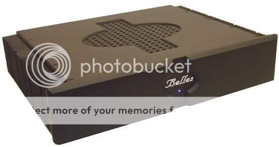

The only speakers brand that you mentioned that I have auditioned are the PSB Synchrony One. First we used the NAD Intergrated amp 180 watts X 2 and to me they sounded weak. (I do have high demands for speakers, I just happen to like high output levels) so we hooked up (2 Belles Mono Blocks) 200 watts X 2. I know it's only a 20 watt difference, but the sound was astounishing. Now was it the 20 watts difference or the higher quality of the amp? Now that is based on medium listening levels.
http://www.powermodules.com/power_modules/mb200_amp.html
