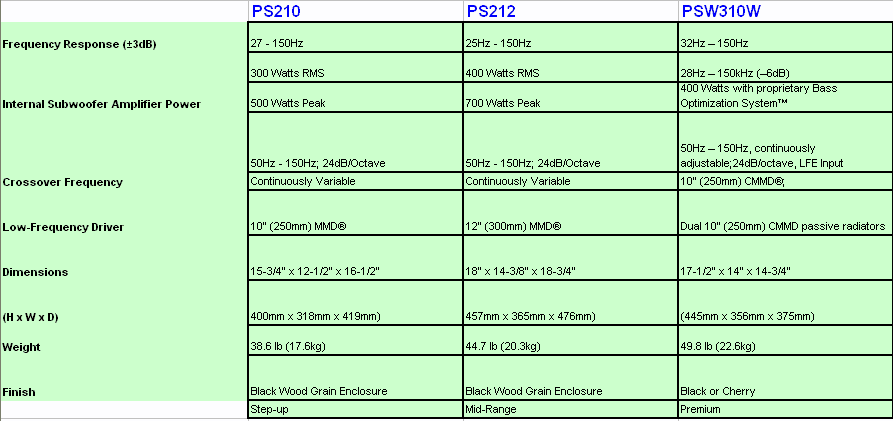

Hwere are the current Infintiy Subs; I compared the specs in a Excel spreadsheet
The main things a larger sub usually has are (1) larger subwoofer speaker diameter, which usually means the ability to go to lower frequencies and(2) more power= louder sound. Size of the speaker and cost, do not necessarily dictate quallity.
