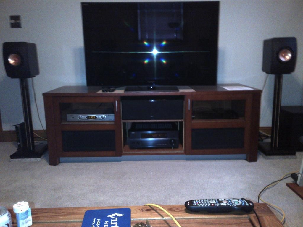

I'm mostly worried about the shelf underneath the center channel, which will hold the AVR & possibly an Oppo 105, 103 or 95 player in the future. My current Oppo BDP-105 is 18 lbs. and let's say the future AVR comes in at 50 pounds, that makes for a hefty 68 pounds.

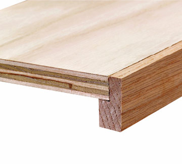

Like Alex said, use ¾" plywood with a hardwood strip glued to the front edge. Maybe a picture would help.
http://www.diyadvice.com/diy/built-ins/materials-and-hardware/sagless-spans/
I agree with the finished hardwood strip added to the front edge of a single and or double layer of 3/4 inch ply, I also like to install the same strip on the back edge when and if you prefer that open concept (no ply back) . This type of woodworking will not deflect at all holding up to almost any HT applications.

… And to top everything off, the so called "family friend" is a custom woodworker, who wants $2,200, with the specs I provided. :eek: I didn't even mention if he could lower the price if I provided the hardware/wood. I suspect I know the answer to that. :D
After looking at those two photos, change your requirements to:
Hardwood for the vertical shelf supports (the legs). Type of wood and dimensions ??
Use ¾" baltic birch or plywood shelves covered with maple veneer. Use more expensive curly maple veneer for the top shelf. The other shelves will be much less visible, so use less expensive maple (or other?) veneer for them. Both top and bottom surfaces of each shelf should be veneered and finished, but ask the woodworker what he recommends for the undersides to keep cost lower.
Stiffen at least the front shelf edge with curly maple strips that are ¾"×1½". If you stiffen both front & rear edges, the rear edge won't be visible, so use less expensive straight grain maple hardwood (or other less expensive similar looking wood) for the rear edge.
¾" thick baltic birch or void free plywood, stiffened with ¾"×1½" hardwood strips will easily support the weight of your electronic gear. You don't need 1½" or 2" thick solid hardwood for this. And, as you've found, it is quite expensive.
Once the maple is finished, and all your gear is loaded onto the shelves, under normal lighting, you should be able to see only the front and top surfaces.
