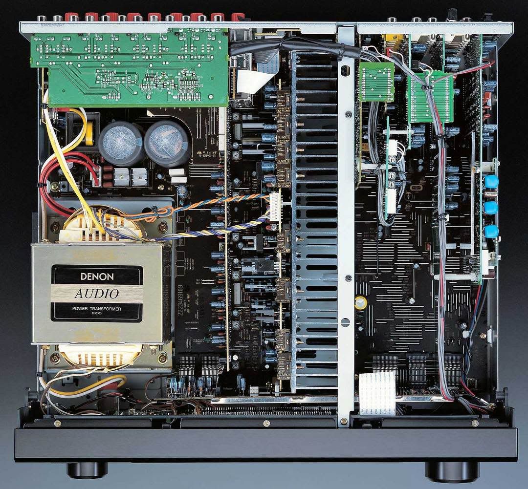

Thanks for the pics. I was curious about the guts of the VSX-9300TX. Those 27,000uF caps don't look any larger than my ES 15,000uF caps. I also thought they would have used extruded aluminum heat sinks as well, but I guess not. I wonder how close in construction the VSX-56TXi is to the VSX-9300TX? Good luck on the repair. Hopefully she comes back like new.

Since we're comparing internals, here's the Denon 3805.
Here's some internals of some dedicated amps, and of course, that old Pioneer SX monster receiver. Check out their caps!
