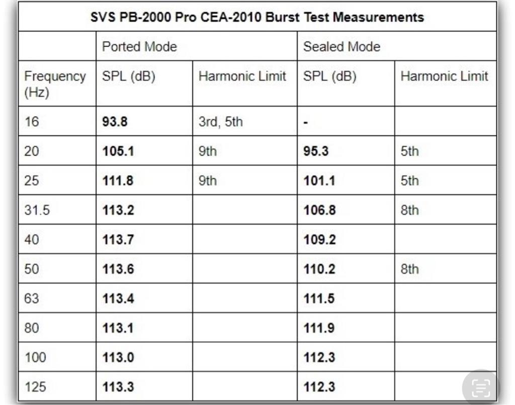

Lol. You won’t probably ever find that spec. That’s kind of a back end thing that just contributes to the subwoofers overall ability to play loud. Or LOUD!!! The sensitivity is meaningless to the end user.
Again, more importantly is the max output measurements from third party reviews. For example…
In the chart you can see max output vs frequency. In standardized tests/reviews this is a yardstick to equally compare different subs. This is what you’d care about.
