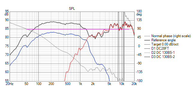

Hello, I was planning on building a pair of the TriTrix MTM TL speakers, however, seeing as the components won't be in stock until June I am looking for an alternative. The DC 130BS is going to be in stock soon, however, the DC28FS tweeters are not going to be in stock for a while. Would it be possible to use the DC28FT instead with an altered crossover? I attempted to design my own in Vituix but I have no experience designing a crossover. Any help would be greatly appreciated.
Maybe @TLS Guy could help you out.
Otherwise, you may have more luck over on the Parts Express Tech Talk forums.

Thanks for the reply. I'll check out the Tech Talk forums.
