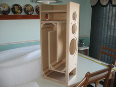

It really is a matter of design convenience and practicality. The driver needs placing at the first node of the third harmonic, to help avoid exciting it. That is still a high pressure low displacement zone. The port is the open end of the close pipe. This is a zero pressure high air displacement zone. Generally there is one fold. This is to keep total enclosure length down, but more importantly to shut of port radiation of higher frequencies.
So that is really the reasons the designs look the way they do.
The length and volume of the pipe have to be carefully matched to the T/S parameters of the driver, and driver selection takes great care. In addition getting the taper, port size and the weight of the damping material correct is also crucial. Unfortunately their are a lot of opportunities to make serious errors along the way
Having said that though, the effort and resources involved are full justified by the end result. Properly designed these speakers eclipse all others in bass quality and especially even distribution of bass in the room due to inherent pipe properties.
Some pictures might help you.
The line.
Relationship of driver and port of this in wall sub.
End result.

Thanks for the replies.
This was my first attempt and I really liked the low end.
I want to make a 2-way unit and have the tweeter and woofer at the top front of a 42" high cabinet.
I was hoping to move the vent up close to the bottom of the woofer so the grill does not have to extend all the way to the bottom.

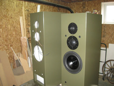

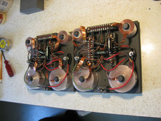

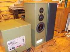

View attachment 32394View attachment 32395View attachment 32396View attachment 32397
Very nice work. I hope it sounds as good as it looks. The only way you could do what you want is to make another turn. The speaker would then be shorter but deeper.
One word of caution. At the mouth of a TL working properly there is a lot of air displacement (air movement). However the pressure is zero. There is always a node of pressure at the port. So that means there must be NO resistance at the port. Loudspeaker grill material should not be used to cover a TL port unless you can have a good deal of clearance between the grill and the box surface.
