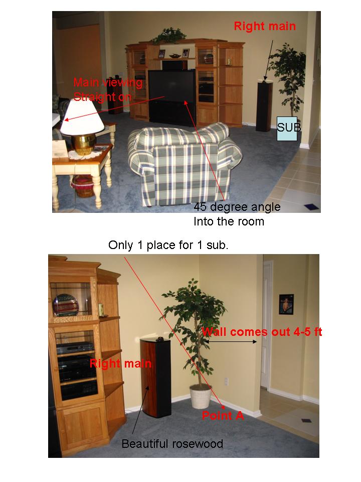

Hi Guys,
Please look at the 2 pics to see my room situation. I have the beautiful Swan Diva 6.1 speakers in rosewood. Close-up pics of the Hsu VTF-3 look like a nice cosmetic match! But is the bass there for my size room. I read all the + posts about Axiom EP500. (Craigsub tells me go with EP500 and don't look back!)
My family room appears to be a tough cookie to fill with bass! The room is 18' x16' with x 12' ceiling. So that's 3456 cu ft. for the room. Make things worse, I have open air on both sides leading into the kitchen and dining room. I guess that's another 2-3,000 cu ft off in the distance....The wife will only allow 1 sub located at the location shown in the attached pic.
I don't need, "break the house down ref-level" bass, but the bass needs to be strong in that room! Can the Hsu get me there! I don't want to fall short and need a 2nd one!
The sub cannot be too picky on location, as shown in pic I have only front corner as choice (WAF)

I have 3000 cubes plus one side is open to the kitchen area with 10 foot ceilings..
I have a EP500 and it works really well.. though I feel pretty good about having the ability to trade it in later to an EP600 if I want :)

Hi Vince,
I have a larger room (7000 cu ft) and bought a VTF-3MKII. It is a very nice subwoofer but it could not get to where I wanted it to SPL wise. With the Turbo it might. I now have a single EP-600 and love it. The 500 is purportedly very close in output and if that is the case I'd say go for it.

Vince,
I have the STF-3 in my 4500 cu. ft. room. It provides nice, tight bass, with more than enough spl's. My gain knob is currently set at a value of 2 (0-10 scale)! The VTF-3 has enough bass for your room, easily.

Vince,
I'm not into crack the walls bass (paid too much for em;) ). I need a sub that can handle War of the Worlds bass giving me most if not all that film has to offer and yet works well with music. The HSU was close but I wanted a bit more and my large space required it. Many would say I'm under-subbed now with the EP-600 but it works for me. Honestly, I'm sure either of these subs would make you happy.

Thanks for all the comments guys....
It's tough to make a sub decision, I live in Orlando, people at work tell you go over to Best Buy get a sub! They don't have a clue!! I have no sub in my system now, so I know, stepping up to EP500 or VTF-3 will be some jump!
You read Axiom sub owner comments, over at their website, and the review here, EP500 is a scary little monster! The VTF-3 comments are very + too. I'm just trying to scale the commnets when a guy says the VTF-3 is not enough bass, if he is bass fanatic, any normal human would say "holy crap"
The VTF-3 in rosewood looks real pretty, will match my Swan speakers, if I have to turn the gain to "6", to get solid basss I'm happy.

Guys,
I received an meail from Hsu, that rosewood VTF-3's out of stock, no firm date..I went ahead and order the Axiom EP500 beast!
