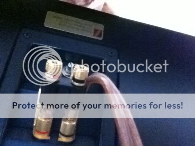

I was wondering if that is a good or bad thing on speakers. It brings out the highs, is that all it is for? I know it's kind of a naive question.

Yes they are on everyone of my speakers by the speaker input terminal. It seems they just increase the treble. I just don't see them on too many speakers. Maybe they increase/decrease both, I'll have to check it out.
All that control is, is a wire wound pot in the tweeter feed. They used to be common, but are not now. They just affect the tweeter output.
Basically a speaker system should have the correct tweeter level to begin with.
The other issue is that even though tweeters are low power, it is enough power to damage those pots over time and they become intermittent. They are not to be recommended.

I had a pair of speakers that had a three position toggle switch.
It had a -3dB, flat, -6dB settings.
Manual said, "Adjustment was largely a matter of room acoustics and person preference."
