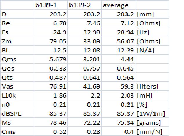

So to upgrading the IMFS, the main question is what bass driver to use. It would be possible to fit up to 280mm diameter (dependant of course on the size of the mid unit) Any thoughts regarding a suitable unit for this transmission line? The existing driver is a KEF B139 SP6171, which is the older version, KEF’s declared Fs was 20Hz with freq range 20-1000. Crossover would depend on the mid unit, but probably ~400Hz. Wilmslow Audio has suggested the Volt 250.8 – is this reasonable? What other drivers may be appropriate? Does anyone have Thiel-Small data for the SP6171 version of the B139? (The TS website only gives the rather different later version, the SP1044.)
