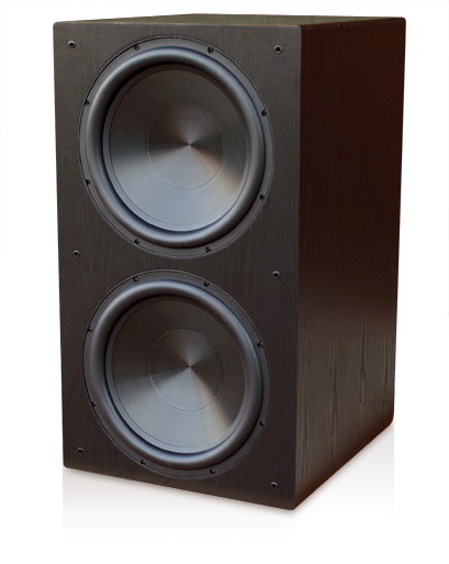

I think a PR design is a good midpoint between sealed and vented, but I also feel it is a bit tougher to design. What is the goal for the sub? Do you want clean sound or extension? PR won't give you as much extension as a vented sub, but will sound cleaner doing it IMO. If these subs are intended to work in a sealed config, then I don't see why they would have a problem with a PR design. Other questions: both in one volume and using one PR? Or two separate subs/divided enclosure each with their own PR?
Why is sealed less desirable? Yes you give up some extension and a bit of output with it, but I generally prefer the sound of sealed subs. With a dual driver config, your output should still be good. Something along the lines of this Rythmik:
