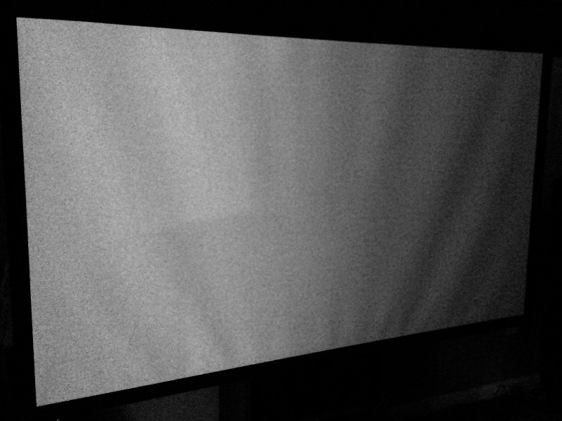

can you offer any screen alternatives that are not so costly and that can be motorized?
No.
Motorized screens basically are a terrible solution. They are like hanging a curtain from your wall, then wanting it to be perfectly flat - it's not realistic.
So, to get a motorized screen to stay flat, you must tension it. This requires a heavy bar at the bottom, and good wires across the sides to evenly pull it in all directions. These tab-tensioned screens, when built right, are far more complex then models that aren't built right, or lack that tab-tensioning.
When you look at tab-tensioned screen, the cheap ones are under $1,000.
ie: http://www.amazon.com/Elite-Screens-Saker-Tab-Tension-100-inch/dp/B00P6UJ4F6/ref=sr_1_2?ie=UTF8&qid=1459696336&sr=8-2&keywords=saker+screen
or
http://www.amazon.com/Elite-Screens-Spectrum-Tab-Tension-125-inch/dp/B00MJ4WAWG/ref=sr_1_1?ie=UTF8&qid=1459696421&sr=8-1&keywords=tab-tensioned+screen
If you want a one which will last you 10-20 years, then you have to spend accordingly. About $1,500-$2,000 for a model which will actually last and provide an excellent image for years (about 100" to 120" in size).
If you want to go cheaper, and get one without tab-tensioning, then why not just forget about getting the motor in it? Just get up, walk over, and pull the screen down! You can get these screens for under $200 with the exact same quality, or better, than the cheap motorized screens. Literally, you are just spending money to get a motor, with zero improvement to the screen itself.
I am using a large, high quality, tab-tensioned screen, and I still have some issues with some small waves. They aren't as typical on screens of 120" or less with tab-tensioning, but it does still require a fair bit of cash to do motorized and get quality. It's just the reality of the request.

I think that is overly critical, they are very common and generally work well.
Oh, they do .... for the first few months - but then they quickly develop waves - you're not going to like to watch a movie on a wavy screen
BMXTRIX
BMXTRIX
In over 15 years in the business now, I have not seen one single non-tensioned screen that didn't have, or develop waves in the material. There is absolutely nothing that separates a non-tensioned screen from a pull down screen except the motor in it. All throughout life I grew up in school systems where the teacher would pull down the screen, and it would have waves in the material. Every school, every state, my whole life.
Since then, I have had the chance to see any number of commercial and residential settings with multi-thousand dollar screens with and without tab-tensioning, and the results are the same and true.
If you buy a screen that is not tab-tensioned then it will develop waves within 1-2 years.
In comparison, a good tab-tensioned screen will last 10+ years and can look as good as the day it was purchased.
The best and most cost effective quality solution remains the fixed frame screen. Just a few hundred bucks now from Silver Ticker or Elite and you get quality that will outlast them all.
