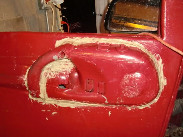

First some pics of the new mustard! I havent spray painted them yellow yet, but here's the re-rejob:

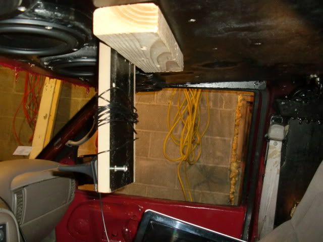

redid the mic rig:

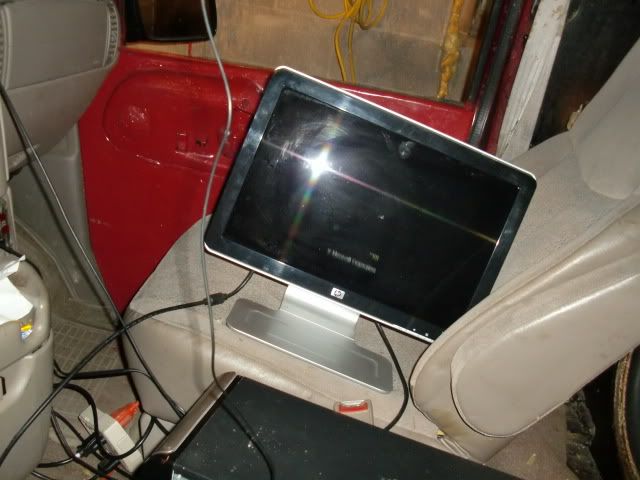

Set the PC up a little more friendly:

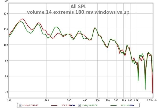

Initial sweep after working volume up slowly for safety
2nd sweep windows up to compare.

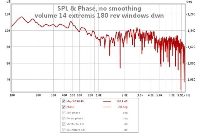

PHASE play!
