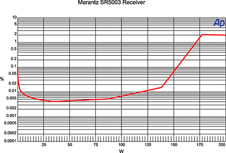

While researching for another thread I came across power output graphs for the Marantz SR5003 (2009) and the SR5009 (2015):
Clearly, the older model produces more clean power, yet the newer model claims 10 more WPC (100 vs 90)!
If we look at 0.02%THD points, we see 140W for the 5003 vs 98W for the 5009!
Both meet the specifications, but the older one had a much more breathing room!
I think it's partially the intention of the spec for advertising purposes which has changed over the years (and a shift in FTC enforcement?). Combine that with a little corporate cost cutting....
Neither Marantz website-provided spec is all that helpful or with all parameters but does seem the older unit was rated more "conservatively". The S&V bench tests show:
5003 2ch driven .1% THD 8ohm 153.1wpc, 4ohm 204.7wpc; 1% THD 8ohm 171.3wpc, 4ohm 239.6wpc
5ch driven .1% THD 8ohm 103.8wpc, 1% THD 118wpc
7ch driven .1% THD 8ohm 88.2wpc, 1% THD 99.9wpc
5009 2ch driven .1% THD 8ohm 111.7wpc, 4ohm 182.7wpc; 1% THD 8ohm 129.8wpc, 4ohm 203.9wpc
5ch driven .1% THD 8ohm 72.9wpc, 1% THD 88.7wpc
7ch driven .1% THD 8ohm 68.5wpc; 1% THD 81.0wpc
