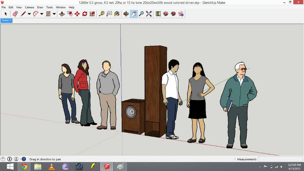

So I'm just getting my build thread ready as I'm almost ready to make saw dust.
G
Gary147852
No reason. Nothing against bfm. Just wanted something a little different(smaller footprint). Plus I hear corner loaded sub horns are the bee's knee's with all that extra room gain.
This is the space I have to work with.
G
Gary147852
On the left is a tiny marty. 20x20x30 slotported. Tuned to 20hz. On the right is the sublimator. 15x16x81.5 offset driver front loaded folded horn tuned to 18hz.

To me that does not look like a horn at all, but a TL.
I did a google search, a lot of math which admittedly I have limited skill with. In layman's terms, what is the difference between the two and how do those differences affect the final product?
TheWarrior
TheWarrior
Gary, in researching this further, it appears you have unknowingly combined transmission line theory with folded horns. Because you did not know who to differentiate the two, I think you have effectively created a giant box that will do nothing but provide a 180 deg phase inversion at the port opening.
A folded horn sub is intended to increase efficiency (which your sub already is quite efficient) so that 'more sound' is heard for a given amount of input. A transmission line is where you create a long duct that acts as a waveguide that decreases distortion, and can increase in room response of the selected frequency over what the driver would normally be capable of producing.
The horn you have designed is barely larger than the driver itself, yet is expected to increase in-room response. Note the sizes of these basic designs for reference using 15" drivers.
Don't build this dude. The design needs to be completely revised! Keep reading and researching, it can be done!

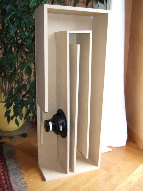

Here is my center channel TL under construction.
And then it is damped.
Unfortunately some authors have wrongly referred to pipe bases speakers as horns, which is not correct. This causes enormous confusion.
MJK
Audioholic Intern
The difference between TL and horn behavior is all in the size of the open end/mouth and the frequencies being reproduced.
If the open end is large enough for the frequencies being reproduced then the sound waves coming down the expanding path will efficiently be transmitted into the room over a wide frequency band. The acoustic impedance of the mouth will be resistive and dissipate sound energy from the enclosure into the room.The electrical impedance of the speaker will be a single hump. This is horn speaker behavior.
If the open end is too small then the sound waves coming down the expanding path will reflect back into the cabinet and form standing wave resonances. The acoustic impedance of the mouth will be mass loading leading to reflections of sound energy back into the expanding path. This is TL speaker behavior generating a series of peaks at discrete frequencies corresponding to the standing wave resonances. The electrical impedance plot will exhibit multiple sharp peaks as will the SPL plots seen in the HornResp output in the earlier posts.
The acoustic impedance of the mouth is frequency and size dependent. An expanding path enclosure can start out behaving as a TL at low frequencies and then as frequency increases gradually transition to horn like behavior at midrange frequencies. For low frequencies the effective mouth area (including any boundary loading) needs to be HUGE for the speaker to behave like a horn. The original design is small enough to be a TL over its entire operating range as evident by the series of sharp peaks in the SPL plots.
That is the difference between a TL and a horn. Most tapped horns or back loaded horns seen on the Internet are in reality TLs at low to mid frequencies.
