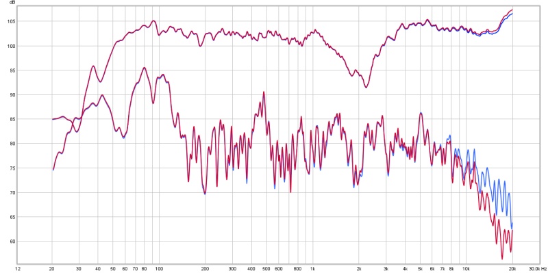

Bass peaks and suck-outs often exceed +/- 7db in residential rooms. In my experience it is quite possible to discern differences of 3db in the bottom three bass octaves, because while hearing is logarithmic sense of touch isn't. Double the power at 30Hz is felt.
With 1/12th octave smoothing I shoot for +/- 3db in the bass at my listening seat, which I've sort of achieved in my current room, but I couldn't achieve that in my previous room, which was significantly smaller. In the previous room I had a 52Hz room mode that I could only get down to a +5db peak relative to 40Hz. I thought it colored a few of my solo piano recordings versus I heard on really good headphones. For rock music the peak was euphonic I suspect.
I have been delayed by personal matters but I hope to get a comparative review of the ATI 522NC and 4002 completed by December.
Here is the graph here each line is smoothed at 1/48'th and represents an average of 3 measurement in stereo (top) and 4 measurements in nearfield mono.
There are some good illustrations of room interaction. Notice there is very little difference in stereo with a fraction of a DB at the top end in stereo mode but nearfield there is a pronounced difference. Weird.
- Rich
- Rich
What are the dimensions of your room? Is it carpeted?
RichB
RichB
No carpeted on the side with the speakers. There are 9 to 10' dropped ceiling.
The room is not square minimum 15' (wider in spots) and over 30' long.
- Rich

Are the L&R speakers on a narrow wall or a wide wall?
Irvrobinson
Irvrobinson
Left is in a corner and right is close to the center of the room. That's where the had to go to be above the pool table.
- Rich
I would have expected a lot more difference in stereo with a set-up like that.
RichB
RichB
Those were with the UMIK-1. I plan to remeasure with it and try some other mics: OmniMic2 or EMM-6. I have calibration files for all.
- Rich
- Rich
I think we have had similar conversation before, that using REW/Umik-1 mic I have found time and again such graphs failed to tell apart any of my preamp, power amp, AVRs, AVP of any permutations. No surprise to me as I never could tell anything more than extremely subtle difference (if real..) differences by ears, but you are someone who could, so I am very curious about this whole exercise. Oh, I didn't even have to do any averaging, the differences (graphs) were little up to 1/48 smoothing or even with no smoothing in the lower frequencies that are not clouded by comb filtering effect.
When you said nearfield mono, did you mean like placing the mic at around 2 meters in front of each speaker, one at a time, whereas in stereo you meant from you listening position with both speakers on at the same time, i.e. setting REW to L+R output (or something similar using other software)?

RichB
RichB
The nearfield measurements are of the right-speaker (only) at about 8 inches to try to remove effects.
The stereo measurements are at approximately 10'. All measurements are taken at the same section only adjusting the volume to match and swapping the amplifier outputs. REW is uses so it should be a mono-sweep played through both channels.
- Rich

PENG
- Rich
Thank you, so those graphs can be compared directly to mine because we appear to have used the same software/hardware and methodology.
