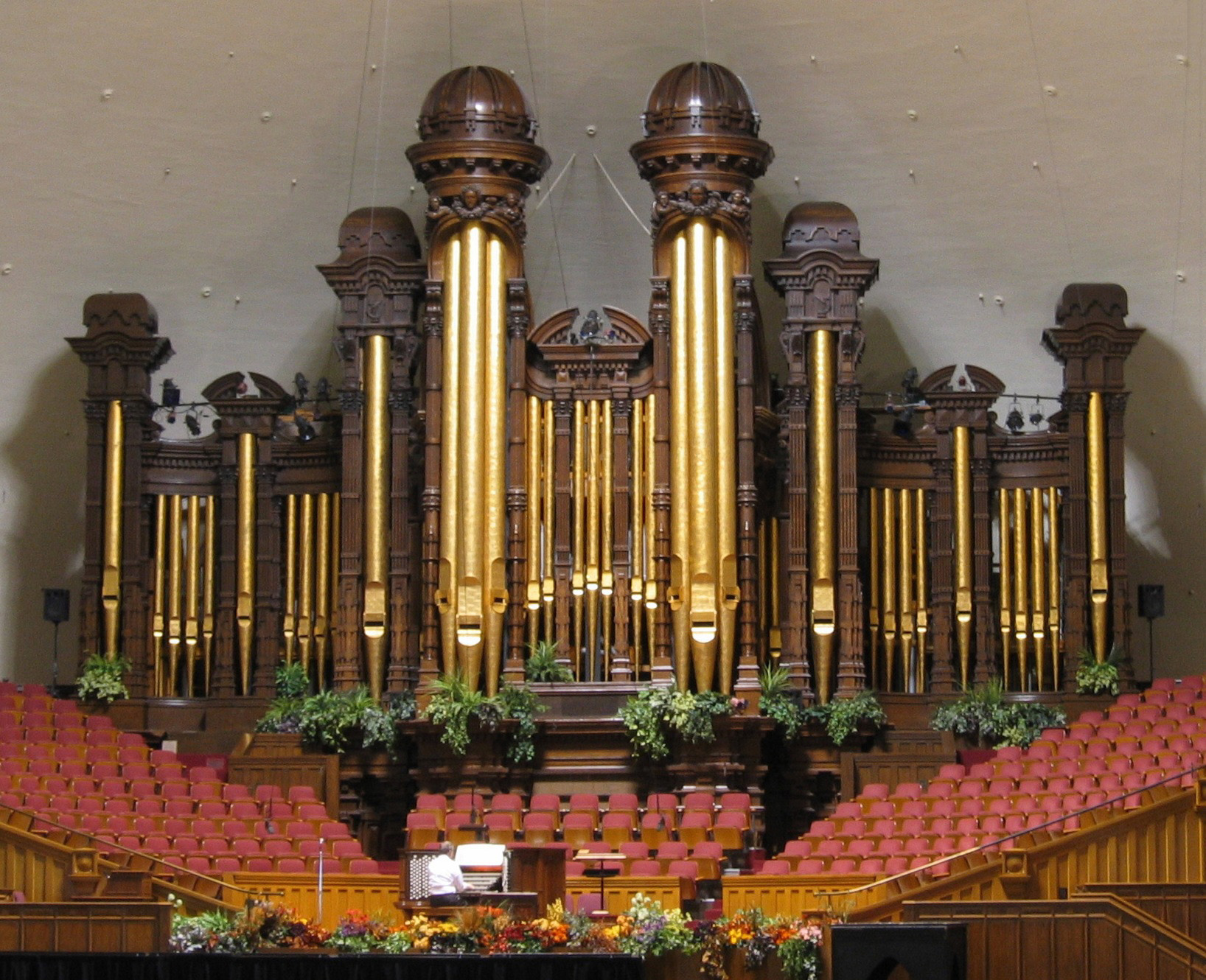

While I am no organ historian or expert, I can vouch for the bigger organs having longer pipes than 16 feet. I am most familiar with the Tabernacle organ in Salt Lake City and the one across the street in the Conference Center. The original Tabernacle organ began its build in 1867 with about 700 pipes. They kept improving it until we have what's there today at over 11,000 pipes. Its not the largest in the world, but its on the list. It has 6 pipes of 32 feet and probably close to 2 dozen at 16 feet.
To sit and listen to them practice on it during the week is awesome. I have had that privilege just a few times and its a great way to spend an hour or so.
