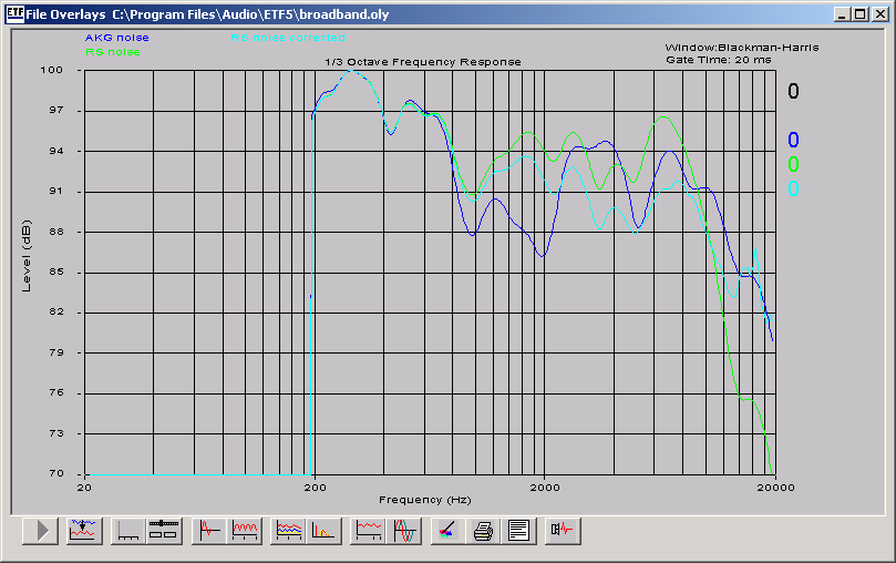

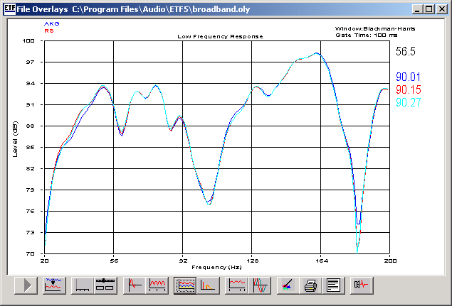

Stop me if you've heard this one before. Below are two ETF graphs - 200 Hz and below, 200 Hz and above - showing the response of my particular RS meter (digital) compared to my high-end calibrated AKG omni measuring microphone. Below about 800 Hz the RS meter is dead on, and no "correction" is needed. But above that the two mikes deviate significantly, and even with the so-called correction curves the responses differ by 3 dB and more. (Which is not so bad in the grand scheme of things.)
--Ethan

While RS meter does not demonstrate a very linear response, especially into higher frequencies, it is sufficient for basic LF response(as you stated) measurement. I assume that the user was only intending to do lower frequency measurements.
But, it is not true that it is difficult for microphone transducers to be relatively flat. For example, a $3.00 Panasonic electret capsule(that is popular with DIYers) has a response that is typically flat +/- 1.5dB(some product examples may go out of this typical tolerance, but not commonly), from 20-20,000 Hz. The same goes for the Behringer ECM8000 measurement microphone. You can aquire basic microphone calibrations for about $40 from Kim G.(reachable on the Madisond forum), but this will only shave off +/- 0.5dB, to bring accuracy within +/- 1dB. Hardly worth the effort, unless you need better accuracy into high frequencies(>15kHz), where the uncalibrated mic may start to deviate by several dB by 25kHz, for example. Also, further accuracy(can be achieved using laser calibration services to calibrate frequencies over 10kHz, approx. $100) is not of practical use, except for labratory reference purposes. Even with a lab-grade calibration, frequency response errors of up to 1dB can still occur(not inherant of the microphone), due to change of air pressure, humidity and temperature that varies from day to day. If absolute accuracy is required, you must have (1) laser-calibrated microphone (2) record pressure, temperature and humidity (3) compensate for environment conditions on the final response curve(s) using the environmental/climate measurements.
+/- 1.5dB variations are of not significant, audibly. While they can be audible(if of sufficient bandwidth) in direct A/B comparison, the difference is subtle.

Agreed, but they're never as flat as electronics. That's all I meant. Also, the actual measurement of higher frequencies in a room is difficult because of all the comb filtering present from nearby surfaces. Even the back of a leather chair or couch creates major ripples at higher frequencies.
