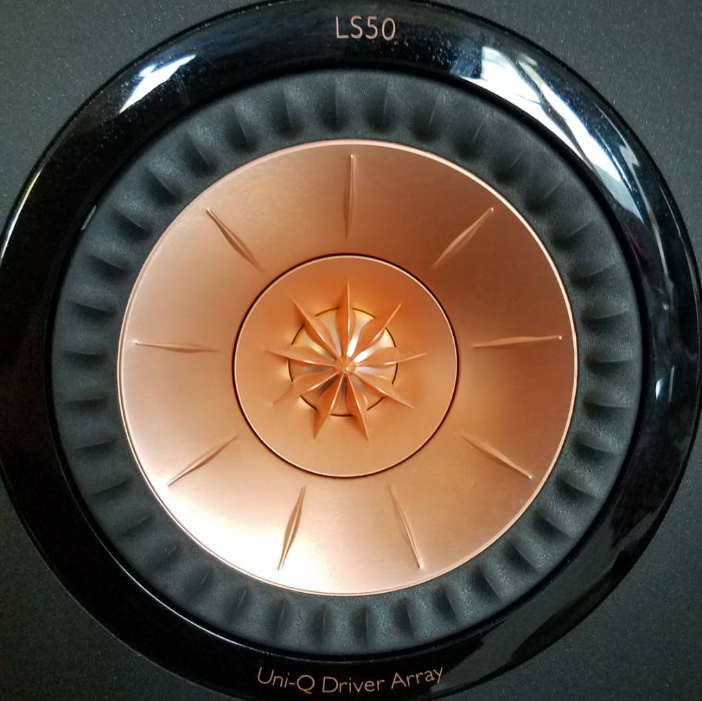

Kef Ls50s have a 3.5 inch (effective) woofer. But it is still crossed over at 2.2k. And it goes to lower that 50 Hz. Go figure. Maybe someone here can explain.

Actually, the LS50's have a 5.25" mid according to their (KEF) very own specifications:
https://www.kefdirect.com/speakers/flagship-hi-fi-speakers/ls50/ls50-mini-monitor-speaker-pair.html
Of course, the tweeter is mounted directly on the mid creating a co-axial type of driver known as Uni-Q. The LS50's are very popular among various forums. Hope to hear them one day myself. :):):)

The woofer cone is much smaller. The surround is bigger. I will measure them a bit later.
They do sound amazing.
Sent from my SAMSUNG-SM-G930A using Tapatalk

Here are the measurements. The gold ring around the tweeter is only about an inch wide and that is the woofer if you can call it that. Inside the ring is the structure that controls tweeter directivity. It is fixed. Inside that structure is the tweeter. The outer dimension of the gold woofer ring is 3.5 inch.
The black around the gold woofer is a cone surround.
Now tell me what size would you call this "woofer"
Hey, I am not trying to be argumentative. But, KEF claims it is a 5.25" driver. I have never owned nor heard the LS50's so I can NOT confirm either way. All I know is that the LS50's are highly regarded here and on other various forums. As mentioned, I do hope to hear them one day. It is certainly on my to-do list.....LOL!!!!! :):):) BTW, glad that you like them. I probably would as well.

Just curious, doesnt the rubber surround factor into the driver's size? If the size is 5.25", that would include the rubber surround or what ever the surround material is/
Many times driver size is measured from edge of frame to edge of frame, rather than the cone diameter itself. The Sd, which is the T/S parameter that determines the surface area that moves the air, typically includes half the surround.

I apologize if I gave the impression of being argumentative. It was not my intention.
By the way, I am also curious how such a small speaker produces so low freq. And if the way I am measuring speaker size is the correct one.
You are correct. If we measure the speaker from its frame size, it will be a 5.5 inch speaker. 1 inch for surround and another inch for the frame. Car speakers are measured like that. Not sure if the missing 1.5 inch center should be taken into account.

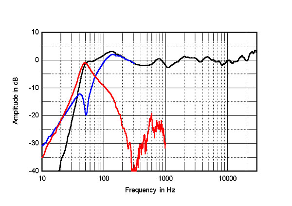

I'm not sure what there is to explain!
The commonly stated woofer size definitely does not refer to the cone diameter. My JBL Studio 580's spec 6.5" woofers and they measure 4.75". So just like yours, the specified driver size is 1.75" greater than the cone diameter. I'm sure this is not absolutely consistent: I measured the 8" woofer in my vintage (early 80's) EPI 100's and the cone is 6", so marketing has had their say in this for a good while!
KEF has been refining their concentric aluminum tweeter/driver design for quite a while, and it is priced above the Ultra, so I would not consider 2.2kHz surprising!
The Diamond 10.1 specs a 5" woofer with a FR down to 48Hz, so for the KEF to hit 50Hz solidly is not surprising. (and I'm sure it performs better in other ways as compared to the Diamond 10.1)
Here is FR for the KEF ls50. Red is port, blue is driver, and black is composite.

Driver size/excursion vs cabinet size vs port depth/width gives the LS50's their base response. It is a bass reflex design, not really a mystery. Not hard to achieve its 55 Hz tuning point a speaker of its design.

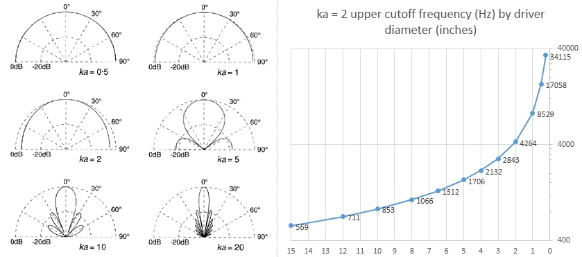

I actually posed a similar question here recently. Honestly, I am of the opinion that the biggest problem with two way designs is that they necessitate an xover point somewhere between 2-3khz. You are correct that a smaller woofer will better match the directivity of a tweeter at the xover, but bass extension is not the only gain when using larger drivers. A larger surface area requires less excursion across the entire frequency range, plays louder with less power and lower distortion. Good luck filling a medium to large room at even -10dB from reference level with a 4” woofer, even if you cross over at 120hz.
For comparison, take the R-15m and R-14m for example, one has a 5.25” driver and one has a 4” driver. The R-15m has relatively low distortion above 100hz @85dB, while the R-14m has significant amounts of distortion all the way up to about 500hz.
In reality, a larger woofer with a lower xover to the tweeter (assuming the tweeter can handle it) will always outperform a smaller woofer, so long as directivity is matched. The only way to achieve this is either multi way designs (3-4way) since very few 1” tweeters can handle xover points below 2khz (even 2khz is pushing it at higher volumes), or horns/waveguides.
Assuming a flat FR and uniform directivity off axis, a two way waveguide loaded tweeter will often outperform a 3 or 4 way design, horn loading a tweeter significantly limits excursion and allows a tweeter to be crossed over much lower, in addition, adding more drivers increases the likelihood of problems such as vertical lobing or power response problems off axis. A waveguide can also restrict the dispersion at the xover to perfectly match the directivity of the woofer.
I know it would seem that I frequently assert that waveguides are the only way to properly design a speaker, obviously that isn’t true, and I don’t believe that, however, that doesn’t change the fact that there are significant advantages gained with waveguides/horns, especially in two way designs, since a waveguide solves most of the problems inherent with them, such as poor directivity matching, and the fact that both drivers are pushing the envelope of their usable range.
If you take a look at this chart, it’s easy to see that it’s near impossible to design a two way speaker where the directivity is matched without using a crossover point so low that you risk destroying the tweeter or at the least dealing with significant distortion. Not only that, but you’re never going to get a flat power response that doesn’t roll off off axis above 8khz with a 1” tweeter without a waveguide.
Diaphragm material makes a big difference too. The R-15m has an injection molded graphite woofer, while the RP-150m has an aluminum woofer that’s sandwiched between two layers of ceramic. Obviously, the cerametallic woofer is substantially more rigid, the R-15m shows increasing amounts of distortion in excess of 90dB below 500hz, whereas the RP-150m remains below 4% THD at 100dB, with distortion only exceeding this level below 80hz when the woofer is pushed beyond xmax, leading to nonlinear behavior as the VC jumps the gap.
The other concern is bass management. I tend to differ with most here purely out of experience and measurements to back them up, but it becomes much more difficult to properly blend a subwoofer above 60hz. Even if we assume 80hz isn’t directional, the issue is the path length from the subwoofer to the speakers. An 80hz wavelength is 14’ long. In order for separate sources to properly sum and behave as a single radiating source, the distance between the two sources must be a a half wavelength or less. That gives you 7’. While you technically could place a sub between the front speakers and be just fine, that ignores the fact you’re also crossing over surrounds or even heights. While you can achieve proper summing with time alignment in the distance settings, as soon as you move outside of the mlp your time alignment is wrecked, much like having a speaker above or below ear level results in a null at the xover frequency. Using a 50-60hz xover gives you 9’ & 11’ of leeway. Not only that, but a good majority of subs, especially those tuned very low, start taking a nosedive at frequencies above the sub bass range (16-60hz). In almost every room, with a variety of speakers and subs, I’ve never had good results with an 80hz crossover. 60hz has always been completely seamless, at 80hz and above, there was an obvious disconnect between the sub and speakers, with a sub placed along a sidewalk, I’ve also been able to localize it on more than one occasion, mostly when listening to music. For HT, it’s less of an issue.

Low fs driver due to either a heavier diaphragm or more compliant suspension, along with a larger cabinet size and the box tuning frequency. The main trade off is efficiency for extension, and usually worse top end extension. Woofer size is often incorrectly associated with extension. A larger surface area can move more air with less excursion, and the larger the diaphragm compared to the wavelength, the better the impedance match to the air at lower frequencies, so obviously a larger woofer will be able to do a better job at reproducing louder bass with less distortion, but it depends on the design.
Many pro audio PA speakers with 12-15” woofers roll off below 70-80hz, trading extension for high sensitivity, often in the mid to high 90s, whereas a 15” subwoofer may reach down to 18-25hz, but barely reach the mid 80s.
