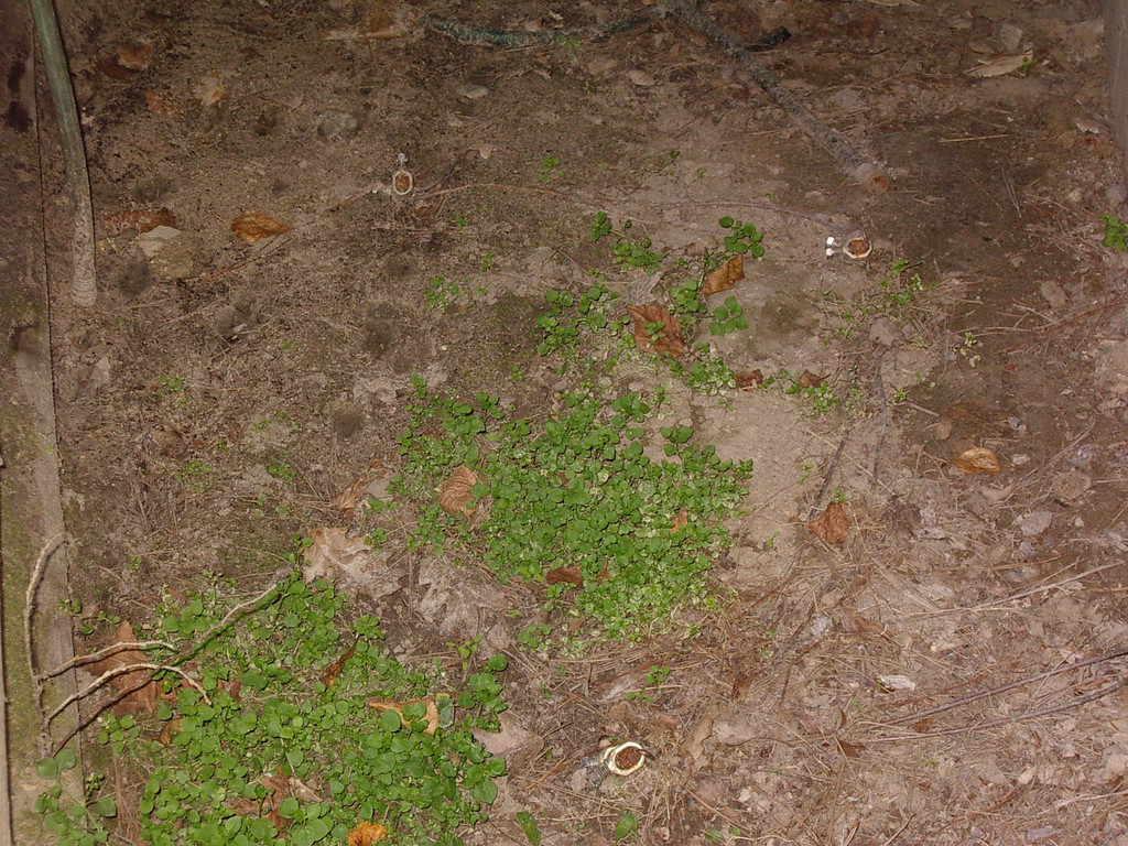

I have recently encountered an unusual cause of hum.
For the last couple of months I had a low level buzz/hum develop. However it was loud enough to just hear at the listening position in quiet passages.
I have been frantically chasing this.
Last weekend it started to fade progressively and this weekend has disappeared entirely.
Now we have had a severe drought here that started August 15 last year.
We had very little snow and NOAA have had us in moderate drought.
Everyone has been frantic about forest fires, and we had one two weeks ago at the town of Nimrod about 30 miles from here, that destroyed 1600 acres, eight structures, including one home and the National Guard was called out.
Last weekend we had torrential rain, ice and finally 5" of very wet snow, that took two days to melt.
Last weekend as we received two inches of water as rain snow and ice, that hum/buzz gradually faded. Yesterday it rained all day and most of the night. Today the hum is gone.
Coincidence? Not likely.
Despite my uber ground of three seven foot rods driven to the hilt into the ground and tied together, the soil must have dried out to the point were the house grounding was not adequate.
So in future when it starts drying out I will give those rods a good watering. I will water them well before putting the hoses away prior to freeze up.
I never thought the water table would recede bleow those grounding rods, but obviously it did!

As I found out! However in my defense we have water seems all over the place and we are over an under ground lake that pushed water up the sand point without pumping, and the grounds are right below a steep bank.
However, it must be so, as I listened a lot this week end and it dead quiet.

I've run into the same problem on jobs with extremely sandy soil. If the ground isn't damp, the ground rods don't pass a resistance test.
A few ways around it, are to add additional ground rods. .
Use Noalox on all the connections, or even or CadWeld them.
When the resistance of a single ground rod is over 25 ohms, the Code wants to see an additional electrode to augment the ground rod electrode, and it must be installed not less than 6 ft away. (I keep them at least 8ft apart)
You can get longer ground rods, but they'll have to stand on a ladder and use a hammer drill with a cup adapter to get them in.
At this point it would be easier to put a rain barrel over the ground electrode and a drip irrigation tube out of the barrel.:)

The soil is quite sandy there as a matter of fact.
There is no downspout anywhere near that location to keep a rain barrel full. However the hose is nearby and there is no water rate here.
So I could rig up a tank for drip feed, in the summer.
The other thing I could do is divert a little water from the geothermal air conditioner. This unit is very close. That is probably my best solution.
