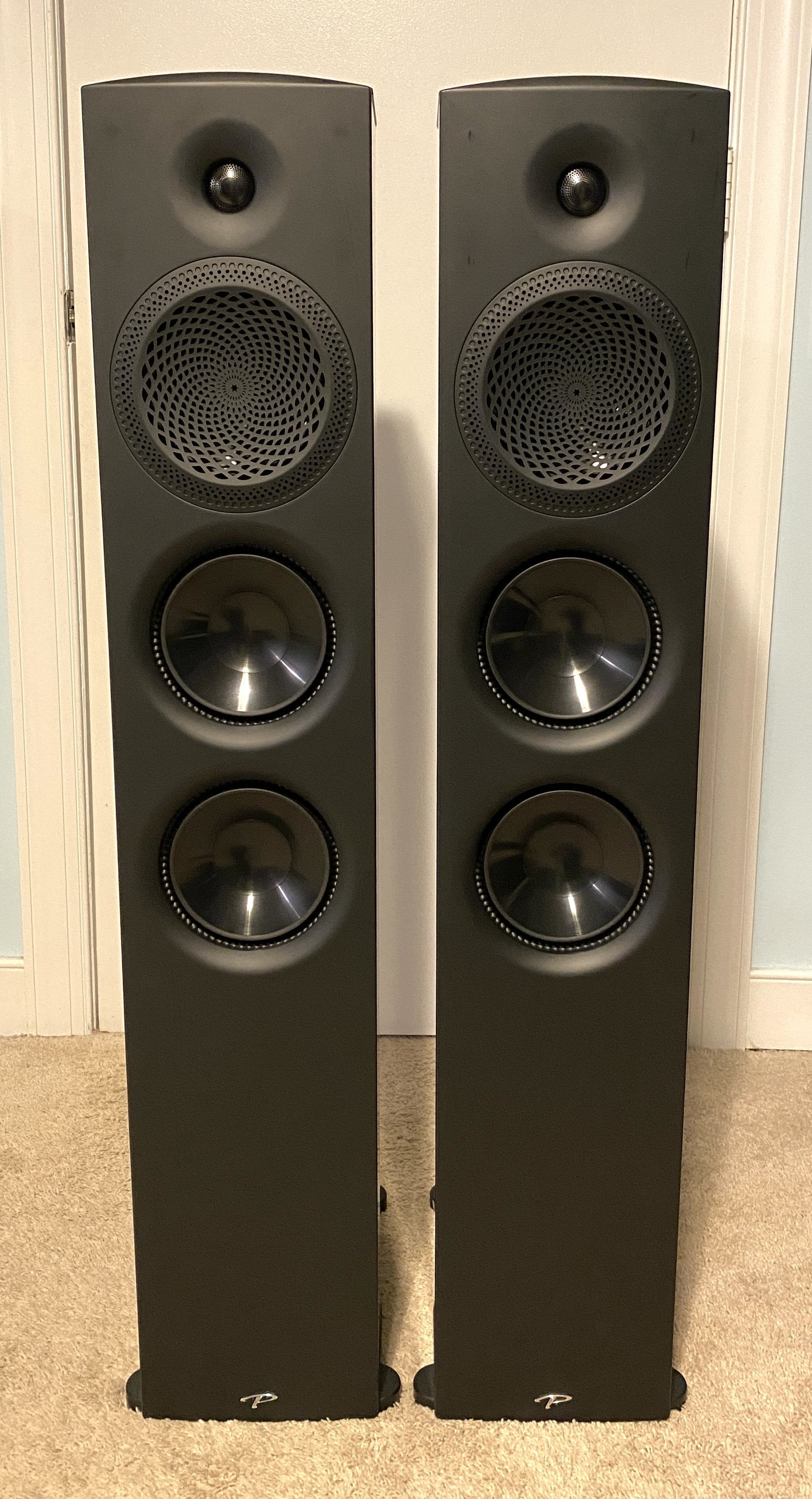

GIEGAR
Let’s say I have 2500.00 bucks to spend on a new AVR, mains, and center channel. How would you spend it?.
Like this Greg:
($400, or $450 new)
($1050 + Pack 'n' Send)
($700 - $750 bid)
