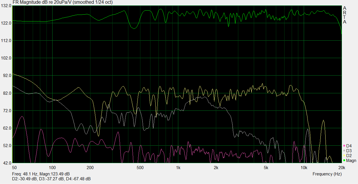

Distortion
I took this sweep at around 95+ db – in other words earbleed levels. Still, the low level stuff is probably contaminated by outdoor noises which I could not prevent. My setup is not an anechoic chamber. Distortion remained below 1% even at these sound levels, which was impressive, because I had to plug my ears during the tests. The well-behaved fourth harmonic indicates that the aluminum shorting rings referenced on SVS' website do indeed do their job.

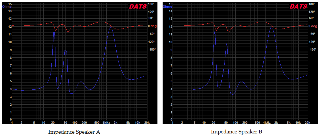

Impedance
The two speakers display good consistency. Although it is specified as a nominal 8 ohm load, I think its current draw in the power-hungry 100 Hz- 500 Hz region sets it as closer to a 4 or 6 ohm speaker. The phase angles are all benign, which is quite the accomplishment for a passive 3.5 way “reference” tower. No need for a super-hero amp, but just be sensible. The dual-peak in the bass shows a vent tuning frequency of 28hz, which is perfectly low for a compact $2000/pair speaker.
