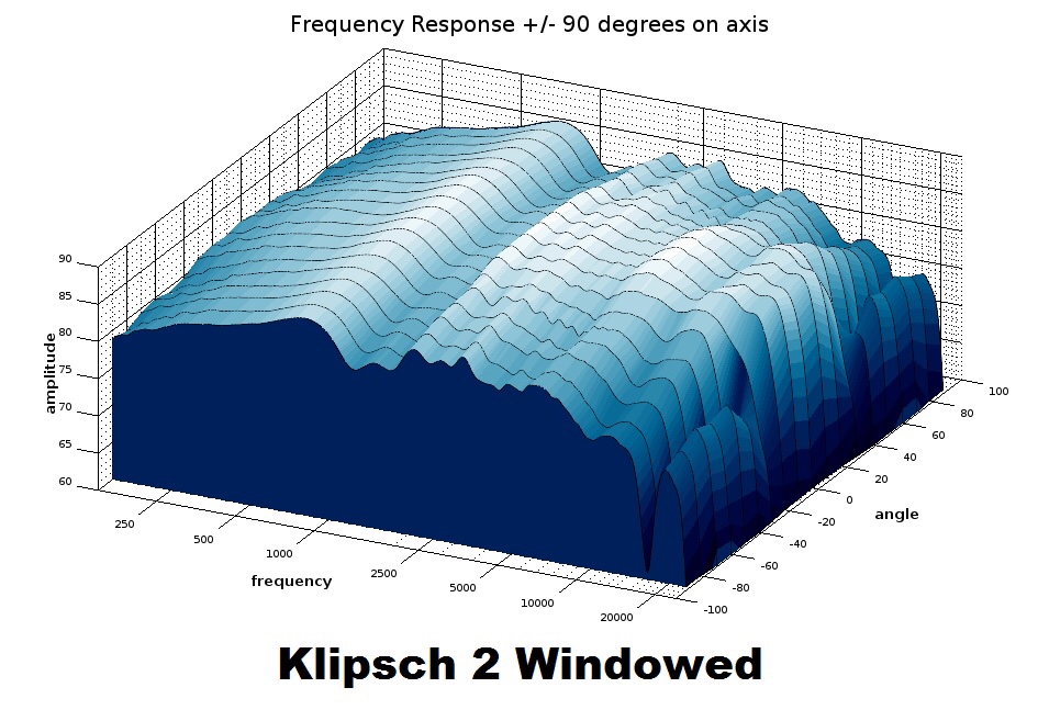

Better IMO. The icon horns had much better dispersion than the reference II tractrix horns, but did display some off axis anomalies and a peaky response, in addition, the ceramic coated aluminum woofers used in the premier series are extremely stiff, I believe this is one of the reasons there is an insignificant change in harmonic distortion between 80dB @1m and 105dB at 1m from 50hz on up. There is almost no breakup or flex even at high levels of excursion (within xmax of course).

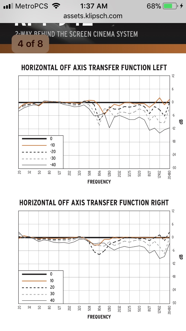

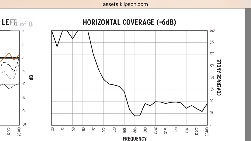

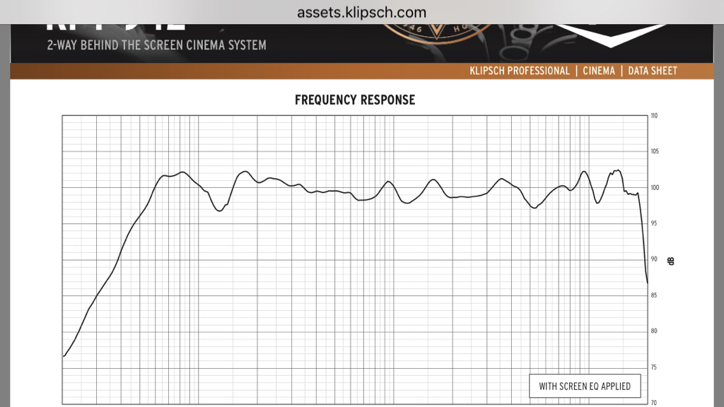

I’ve heard both. The various iterations of the icon series seemed almost as if Klipsch was “experimenting” with different horn designs in order to achieve better dispersion and a flatter response, eventually settling on a modified 90x90 tractrix in the icon K series. The Reference premier series uses a very similar horn as the icon K series (which is the horn used in the new cheap reference) with a few modifications, such as the conical throat and molded silicone vs plastic. The design is so far removed from any traditional horn curvatures it’s difficult to pinpoint what it’s supposed to be, all I know is it works very well. Klipsch seems to have solved all of the problems inherent with horns, such as brightness, and beaming at high frequencies. The goofy looking flower shaped horn was not without problems. The premier series is a near perfection of the many designs Klipsch has used throughout the years, including trickling down of the same technology used in their cinema series, such as the K402 horn, which was designed for a flat response with constant coverage across the radiation pattern. If you go to the Klipsch website and download the data sheets for any of the cinema series utilizing the k402, you will notice the off axis dispersion and directivity in the above measurements closely resembles that of the k402.
In my opinion, the reference premier almost does everything an ideal speaker should do, a flat frequency response, quick transient response, hair trigger dynamic range, low THD at very high volumes, an absence of IM distortion, despite being a two way due to the horn loading, and controlled dispersion with excellent off axis frequency response. The only issues that stick out is a null at the crossover point above the speaker off axis vertically, but this is near impossible to avoid unless an extremely low xover is used or a coaxial design.
