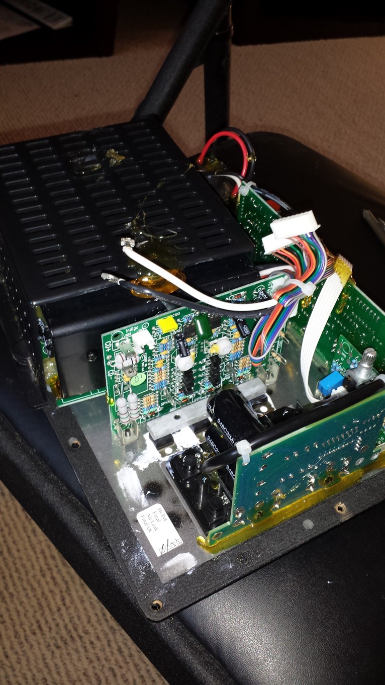

I opened it up and took a look at the amp. Looks like I have 4 burned resistors. I went ahead and called SVS and spoke with Sonnie. He gave me a $50 discount on the new amp. I had the old one (Bash) so I'm getting the Sledge amp to replace it. I ultimately decided to just bite the bullet and buy a new one. I figured if there was a big enough problem with these amps that they switched to a different one; if I end up being able to fix it it'll probably just break again. Didn't feel it was worth the time. Maybe I'm getting old and lazy ;)
